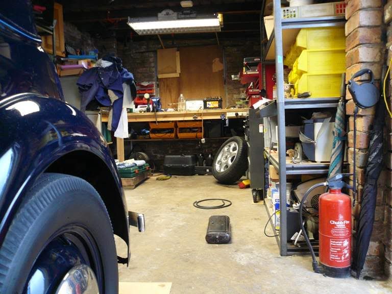

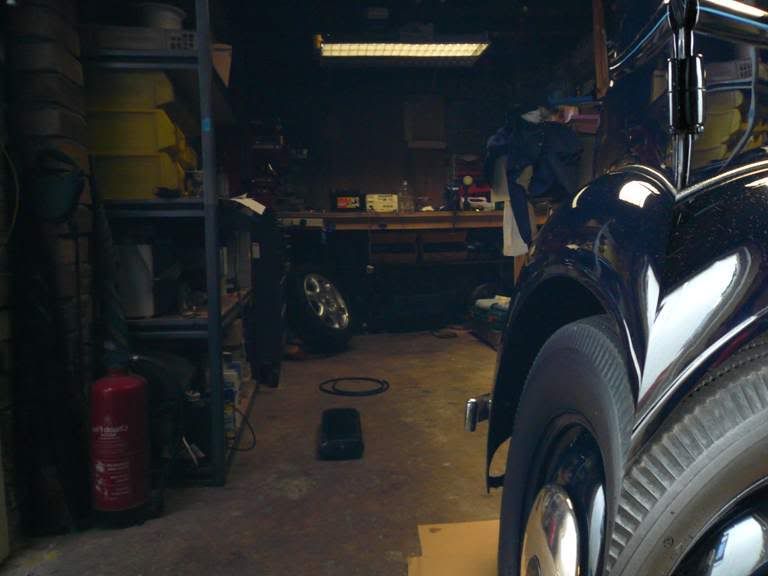

Here are some more reflection pictures.
This is a picture of my garage through the door of the P2
This shows roughly how the picture was taken, I did have to move slightly to show this
Finally this was looking into the garage and no reflection
