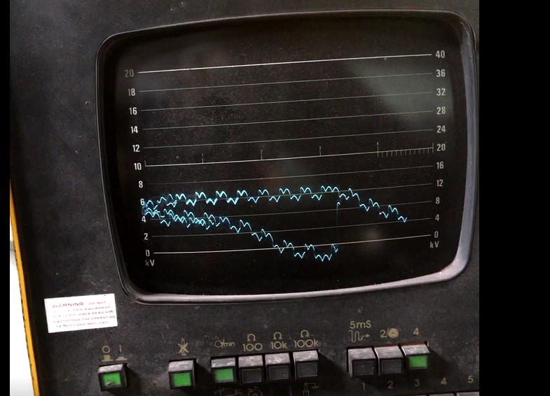

This is the trace on the Crypton, which isn't as nice and even as the one in the manual:
Any ideas on what might be causing this issue? The brushes look almost new, the whole thing is very clean inside other than the bits of rust that I mentioned above.

The Crypton scope display is still the same, so that maybe points to an issue with the Crypton rather than the alternator. It's outputting up to 15v (and sometimes up to 15.2v) so it does at least look as if the charging is OK.
Someone on another forum posted that the trace should be basically flat, as the alternator should be outputting DC. Given that the manual has a similar shape to the trace that I photographed, why would that be? _________________ 1976 Vauxhall HP Firenza, 1976 Vauxhall Sportshatch (x2), 1986 Audi coupe quattro, 2000 Audi TT |
