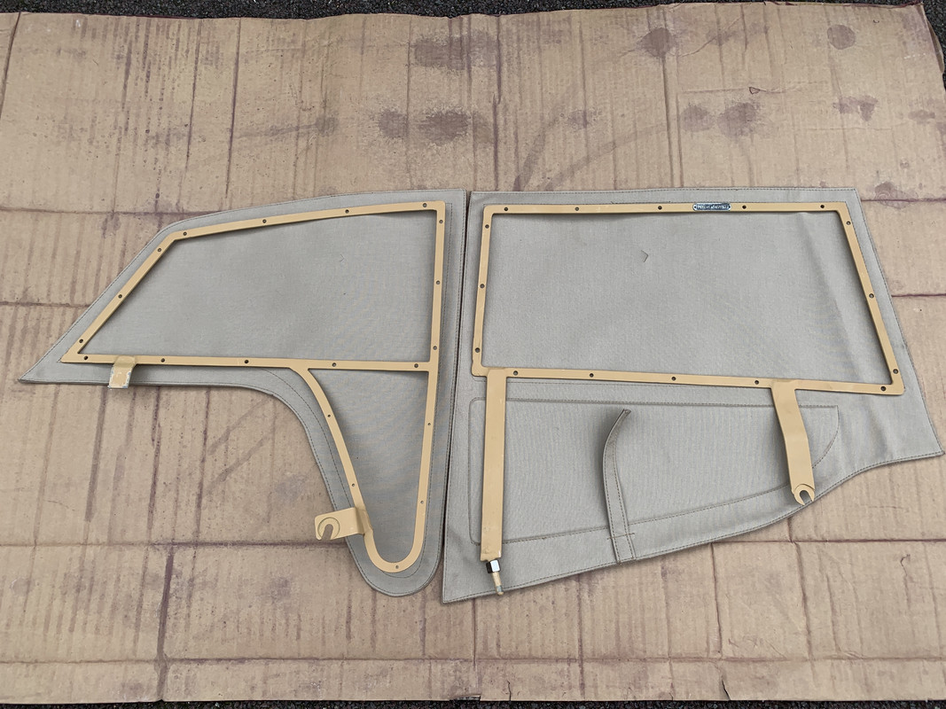

Getting back to the side screens. I don't suppose they will be used that much, however they need to be there for a complete restoration ...but they do take up a lot of time.!
One thing I have discovered is that the frames don't line up when on the car. As I would never be happy with a 'stepped' side window profile I have been experimenting with my own "adjustments".
One issue I wish had come to light earlier is that the front struts are too short to meet their respective clamps inside the door. This comprises a chromed plate screwed to the door card, with a stud and wing nut that enables the slot in the end of the strut to secure the side screen to the door. Correct positioning of this clamp is necessary for the leading edge of the side screen to butt up to the recess in the end of the windscreen fame; it would be all too easy for the closing fit to be a poor one.
I have already detailed my repair to the 'claw' but in addition I need to extend the strut by at least an inch.
Regrettably, I failed to appreciate that I would need four clamps so have just had to order another two at an exorbitant cost of 50 pounds!
One thing I have noticed just in time is the side screens stitching. I had considered using it as a guide for locating the material onto the frames but as can be seen from the photo the two do not match up.
I am tempted to stick the screen material to the frames and offer them up to the car before fitting with screws and chrome trim. That way I can be sure the screens are where I want them.
Once I an happy with the fitting, the material covering the perspex can be trimmed away.
Once the side screens are in place I should have a better idea of where the hood frame mounting plates needs to go. As this is a replacement body tub with new trim, there are no indicators to show where they should be attached; although I do have various measurements to guide me... but as everyone keeps telling me... each car is different, one from another.!
