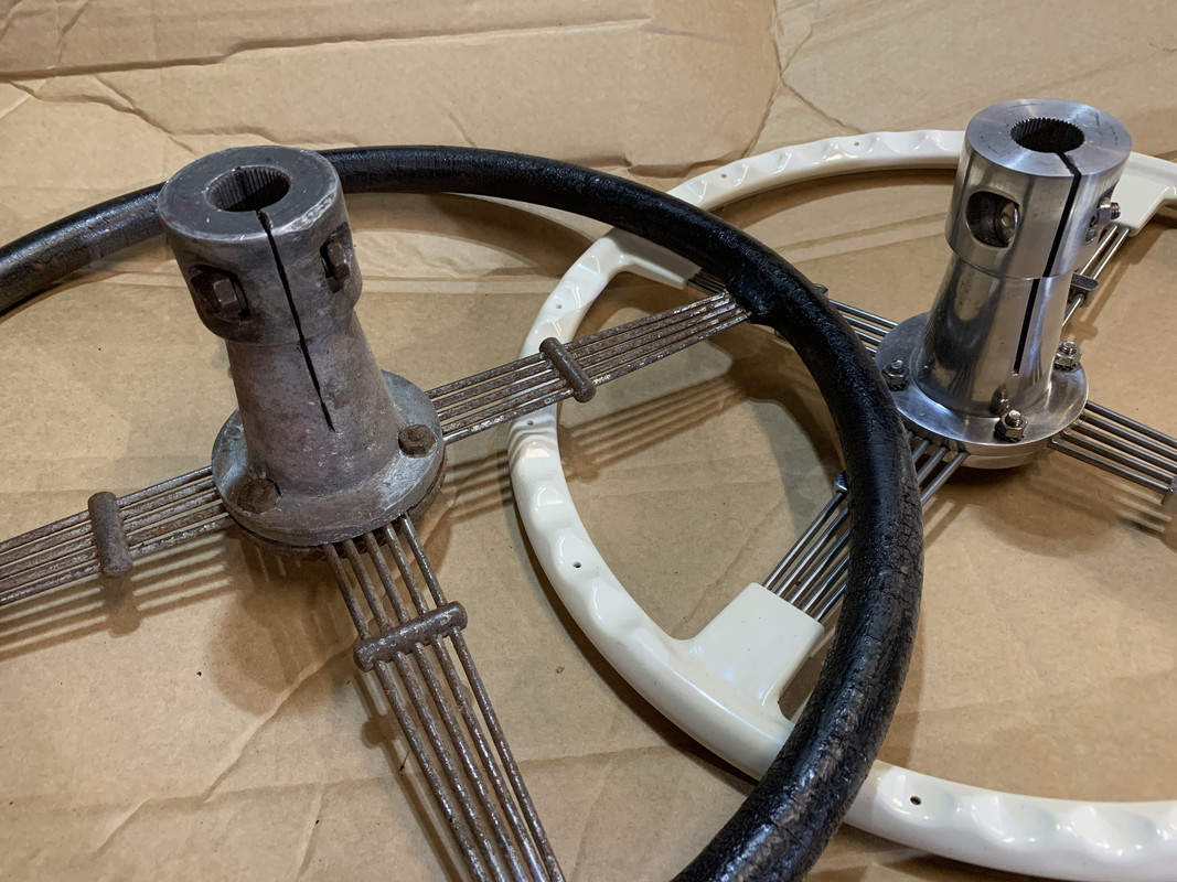

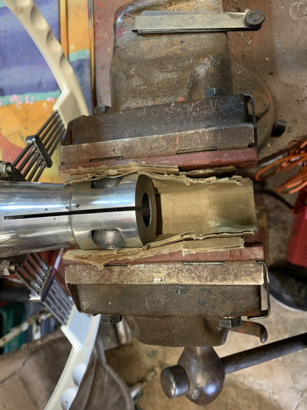

I would put it in the vice with some wood or Aluminium round it for protection and nip it slightly to close the slot little by little then it might tighten up alright.

Thanks for that suggestion. I will measure the gap carefully before and after pinching it in the protective jaws lined with some soft material.
Posts: 1476
PostPosted: Tue Nov 04, 2025 9:40 am    Post subject: Reply with quote
Penman wrote:
Is the gap actually closing at all or have they machined it in a metal which won't give? It is quite a thick section.
Agree with Penman. Should be half the thickness and even then it might be hard.
Posts: 4264
PostPosted: Tue Nov 04, 2025 3:47 pm    Post subject: Reply with quote
I think it is polished stainless steel. Perhaps if it had been aluminium it might have closed up?
I just don't know what to do.
Ideas I have had include sticking aluminium foil around the shaft splines?? Probably won't work unless the boss closes up a bit...
First thing to establish; is there a difference in diameter between the VW & MG shaft? If yes and it requires a shim, you will clearly need to be very careful that there is no chance the shim could break up or skid. As others have commented the boss looks incredibly thick! requiring some force to tighten up on the shaft, I'm assuming that its a "production " steering wheel so presumably fit for purpose?
Posts: 7210
PostPosted: Tue Nov 04, 2025 5:57 pm    Post subject: Reply with quote
The old and new shafts are the essentially the same. The new shaft measures 0.0875" and if anything the original is very slightly smaller but this may be due to wear.
The boss on the old wheel is the same thickness as the new one. One difference is that the new one has a gap (at rest) of 0.080" but the original one is only 0.050".
The other main difference is that the old boss was made from aluminium but the new one is stainless steel.
So far I have only managed to reduce the gap by 0.020" by clamping in the vice.
Possibly the only solution will be to use the original boss. It could be polished up to a high standard but would take me quite a long time.
I suppose I could always paint it black to match the column?
(That would please the purists.! Razz )

Did you try tightening the bolt after it was squeezed? I would use a temporary high tensile bolt and if it broke under tension it would not matter. I would continue to squeeze the gap to get close to the same gap as the old one by going slightly further and letting it spring back to the desired gap.
1985 Rover SD1 VDP
Posts: 4264
PostPosted: Wed Nov 05, 2025 6:36 am    Post subject: Re: Steering Wheel Reply with quote
I agree, get a big bar and crank it up, do or die time, the worst its going to cost is a bolt ! Or use an old trick; heat the bolt up, insert and quickly tighten up and then let thermodynamics do the rest.

Having left the boss in the vice overnight I am still unable to pinch it up to closer than 0.080"...still not close enough to clamp onto the shaft. Mad

Ray, they way you have the boss in the vice wont apply the force in the right place, I'd put a couple of sockets (or suitable diameter steel bar) in the screw recesses and then put into the vice with the force applied to the sockets. Dave
