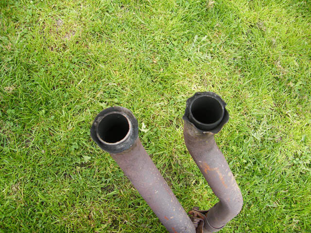

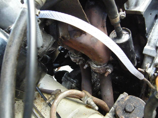

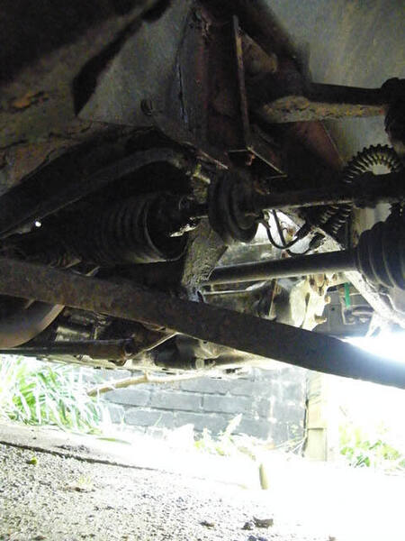

April 2012 and I finally get my first proper look underneath the Princess. The reason for this was trying to get to the bottom of why the exhaust kept blowing at the manifold to downpipe joint.
The exhaust clamps themselves were these fiendish bent metal contraptions that are an absolute nightmare to align and tighten up properly in the space available.
With the exhaust removed from the car, it quickly became clear why it wasn't sealing properly, the flanges on the old downpipe being quite badly distorted.
After some effort, the flanges were straightened out and, thanks to there being more than one pair of hands available, the exhaust was reconnected and the exhaust blow, for a time, was cured.
It wasn't to last, and the exhaust would continue to blow after only a few days/miles before I just resigned myself to getting it nearly sealed and leaving it alone. In the meantime, one of the steering rack gaiters split.

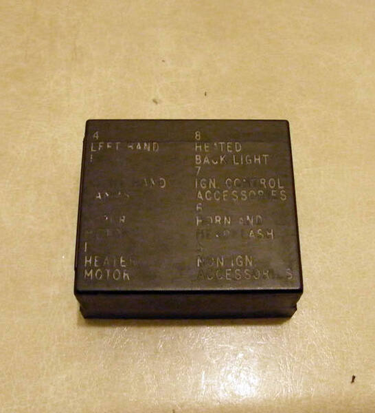

And I restored the text on the fusebox with some enamel paint and a tiny paintbrush. Sometimes we all need an easy win.

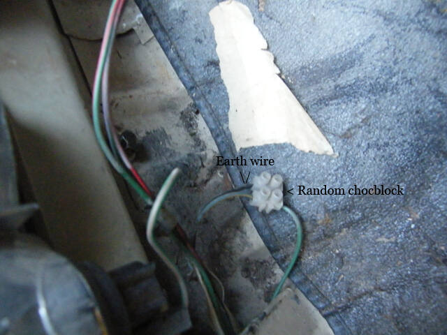

June would be the month that electrical gremlins began to appear and I would learn that most problems with wiring are down to a poor earth. It was hardlys surprising we were having issues due to how the wiring had been attacked in the past with some interesting solutions to fitting aftermarket items like the tape deck and the rear fog lights.
That was sorted as best we could and the gremlins evicted for a while again. Our first car show to be attended was RAF Waddington and the car performed fine there and back and drew an interesting assortment of opinions. Before the show, a thorough clean was undertaken and a little surprise found under the front bumper.

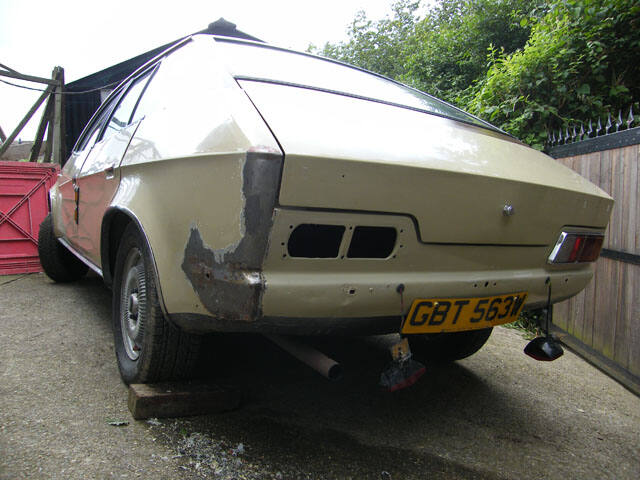

A few smaller items were repaired, and yet we still had bizarre disco lights at the back of the car with no clear cause. Eventually, we removed a light cluster and inspected it to find the chrome plating was the cause of the issue, these clusters ground through the chrome plating on the plastic rather than a separate earth wire.
Since I didn't have a better light cluster to use, the solution was aluminium foil tape and that worked really rather well.

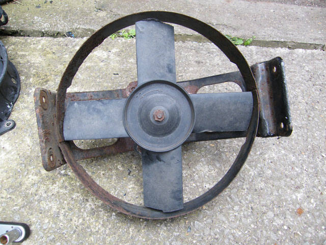

August 2012 and the fan had started to make an horrendous noise occasionally. We had thought it was bearings in the motor gone bad. The difficulty was that it was an intermittent issue, so trying to find or make the noise reliably was proving difficult. The cause was a little confusing, somehow the fan blades had made contact with the shroud. I never did get to the bottom of how this happened.
The problem was resolved by fitting a Rover 200 fan which served well until I could replace it with a replacement Princess fan some years later. Then a little later in the month there was a failure to proceed.

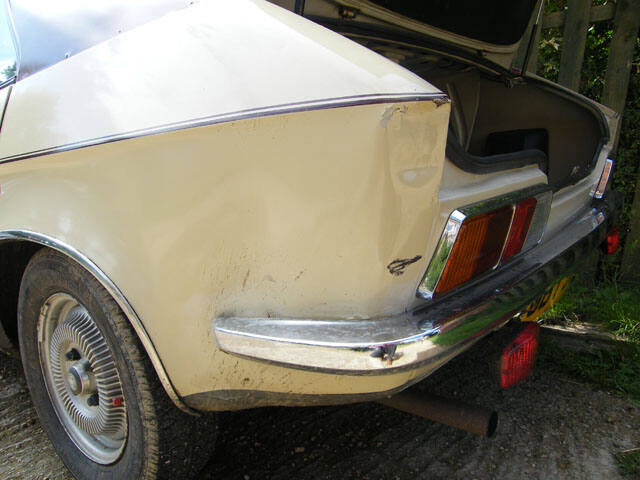

Then there was a little bit of an incident where the Princess wrote off a Corsa.

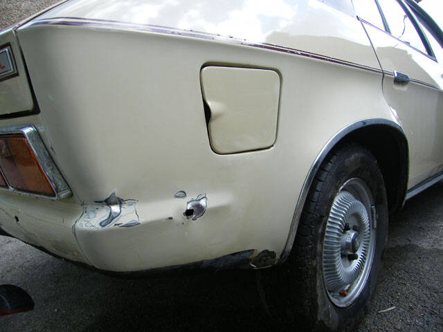

The Princess was parked on my parent's drive at the time, normally I would park on the road but on the last few visits, I'd had my wheel nuts loosened while I was visiting and because we didn't know who was doing it, deemed it safer to park on the driveway.

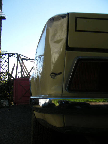

Unfortunately, their neighbour managed to completely not see the Princess while reversing onto the drive (shared access), and smacked into the Princess hard enough to shove it several feet down the drive and cause enough damage to his Corsa that it was written off. This is the opposite corner to the one I'd just repaired after my own mistake with distances.
Fortunately the damage was superficial to my car. A bit of a dent, some damaged paint, and a bent bumper bracket. Some time with improvised hammer and dolly, paint stripper, and sandpaper, and I had the rear end somewhat back to the original shape again.

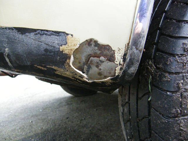

Before I could repaint it, I was finding other areas were the old respray had failed too, it was all quite disheartening at the time. It turned out the old respray had been done badly, it was coming off quite literally in sheets in places where it simply hadn't bonded.
There was nothing for it, this was one of those jobs that was going to get a lot worse before it could get any better and very soon, the car was looking like this as I tried to get to the bottom of the problems on just one panel of the car.
