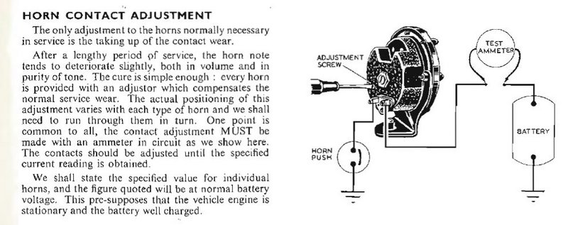

Note the position of the inconspicuous adjusting screw.

MVPeters wrote:
It's a bit late now, Ray, since you've dismantled the horn, but a couple of times in the past I've re-tuned horns of that type.
I've just cleaned the contacts, connected 12V & gently tweaked the adjusting screw. Slowly turning the screw makes the horn rattle, then beep, then squawk & finally parp the way it should.
Me too but I was told by the p.o that the horn was u/s. and I was intending to fully refurbish it anyway.... but I can't see any way of removing the coil - even if I could get a replacement.

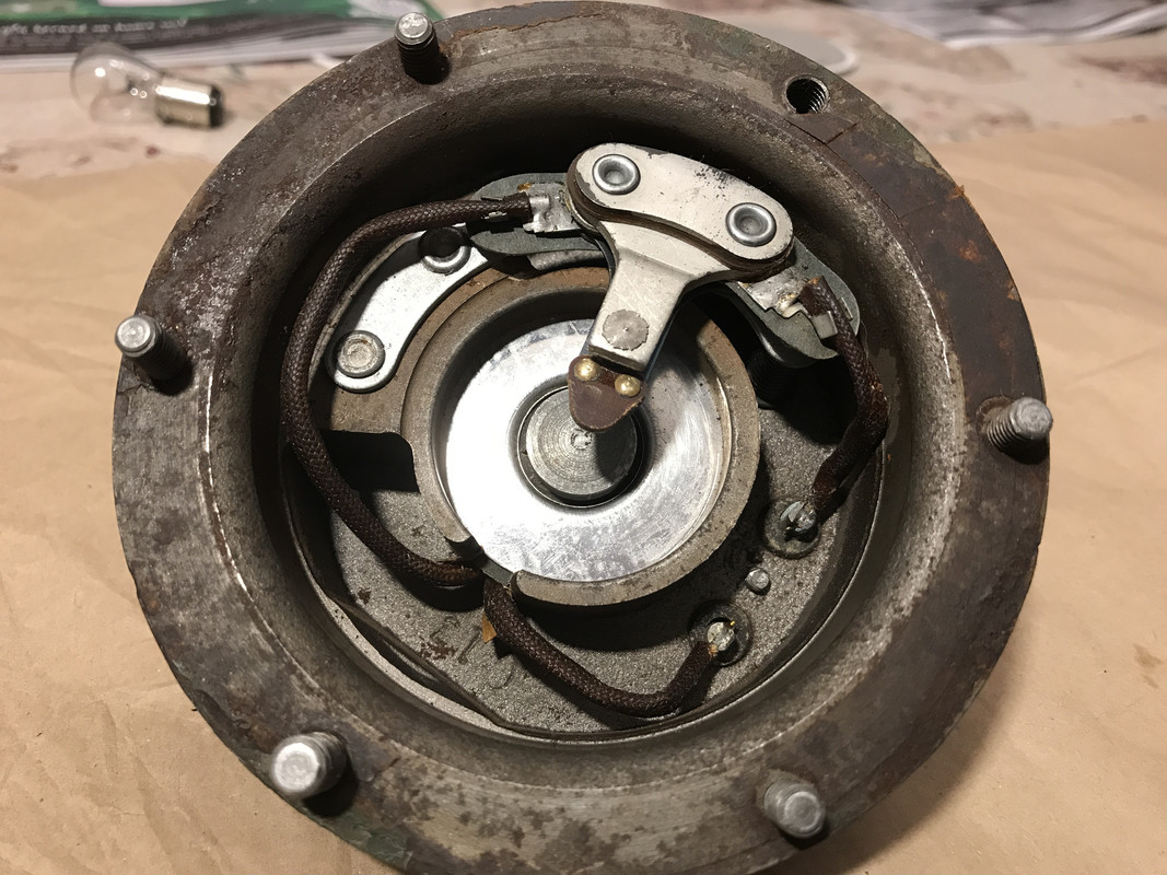

I must say it would be a great relief to me if I could show that the coil is sound. I also had not expected to find a problem with the winding. I may be wrong but I would have thought if the points stuck shut they would have burned out first??
However, I have checked and cleaned the points and found nothing amiss. I tested across the points but got nothing so perhaps there is a wire broken inside the cloth covering?
I have also made sure the wires are not shorting out on the sides of the body and the connections are good....
Confused
Not withstanding the rusty diaphragm; the parts all looks to be in exceptionally good condition.

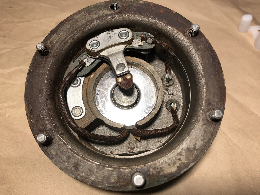

I could try it Pete; but those soldered connections.... they look just fine to me.
Another view from a slightly different angle:
