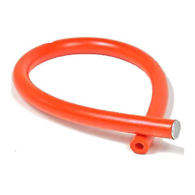

It might help... but pumping clean fluid through should push all the air out.
The thing that can happen is if the pedal is not kept down while the nipple is tightened, then air can be drawn back in. To avoid problems with bleeding brakes I have always pumped the pedal using a simple rubber bleed tube - blocked at one end - with a small split in it submerged in a jar of clean brake fluid.
I have always had to manage on my own and never had a problem with this method in 50 years. Maybe I have just been lucky.
