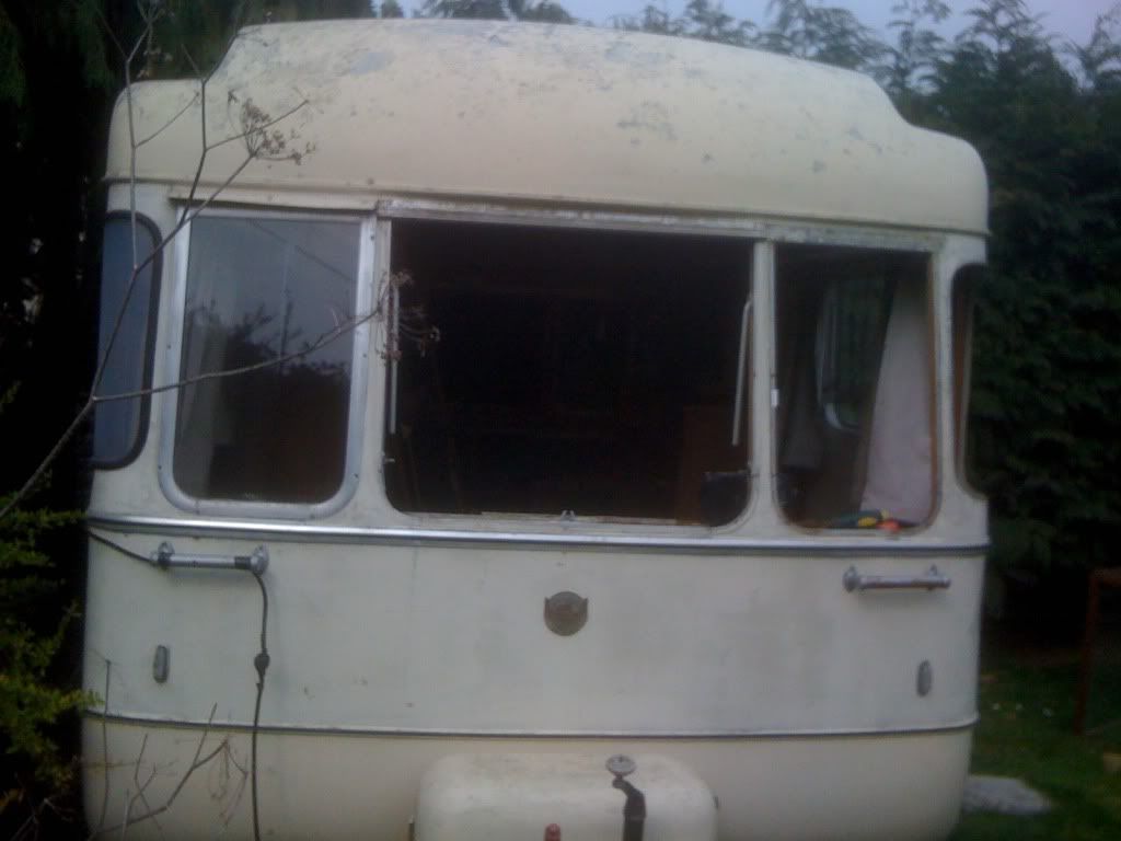

We have just started refurbishment of our viking fibreline. The interior is not bad but the windows need sorting. We need to replace the seals and also the curved windows - if anyone can help with helping us locate the appropriate seal and how on earth to replace the curved windows we would be really grateful!! I have enclosed some photos - we still don't know very much about the caravan - age etc!! [img]http://i1190.photobucket.com/albums/z453/finandarch/caravan26.jpg[/img

PostPosted: Wed May 04, 2011 8:40 pm    Post subject: Viking Fibreline Reply with quote
Hi Finandarch, I also need just one curved window so if you get offered lots perhaps you would let me know!! Mine sadly fell out on its first journey home. It is, apparently, possible to get them made but when I tried that I found it just wouldn't fit. I gather it's very tricky to get the curve just right but good luck anyhow. I now have a thin piece of aluminium in place as a temporary measure instead. The good news is that I know of a supplier who does, or did, the correct, small size of the rubber trim. (I was told the stuff for an old Mini works but I found it too big.) I got mine about 4 years ago so I hope they are still in business. They are C O H Baines Ltd, in Tunbridge Wells. 01892 543311 www.coh-baines.co.uk
It comes in two parts, the seal and the bead to go through the middle which tightens it. The part no were IRS 0768 W/S and SF1B and it cost a huge total of £7.21! They did also sell a tool for fitting it which might be a good idea.
I'm also looking for the white capping which goes around the inside of the windows. I'm finding it v hard to get this narrow enough. Any one had any luck finding this?

PostPosted: Fri May 06, 2011 9:52 pm    Post subject: Reply with quote
The curved windows are made from perspex.
Cut some perspex to over size,mark out the centre line,(remember it is not vertical) gently heat the perspex with a hot air gun and fold over a former,( something the size of a 1 gallon drum.Heat the perspex gently whilst bending it over the former,(two people make the job easier).When you are happy with the contour you can then cut it to size to fit the apperture.That is how I did mine.
