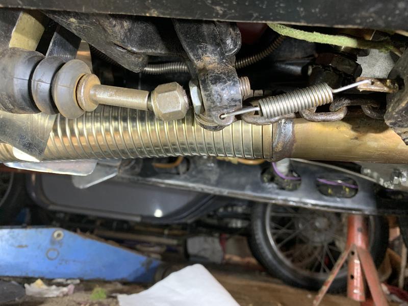

I found a more suitable type of spring. After shortening it and forming a new "hook" end, I fitted it to the car.
The good news is that my brake lights are working again.
Very Happy
Not wishing to sound negative but in terms of design, both the brake and clutch operations leave quite a bit to be desired. Their design can either be described as ugly, clumsy, poor etc. ...
...or you could claim it is quaint and what looks like a "lash up" simply adds character.!
Personally, whether it is the cobbled together brake pedal assembly or the awkward clutch, with its chain operation (yes, chain!! ....it is just visible in the photo)...as long as it all works O.K. I don't really mind. Very Happy

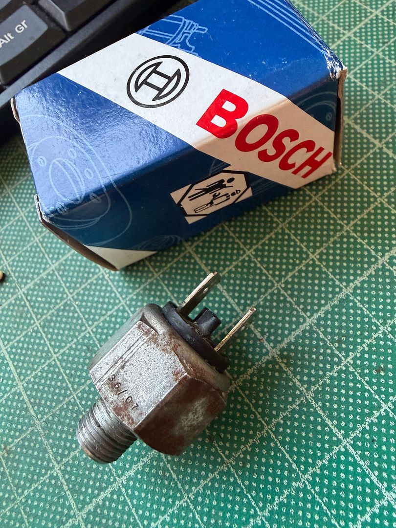

With good reason! Some of the repro switches are awful, my dad had so many failures in his Morris 1000, that he added a brake light tell tail waning lamp to the dash!
When I replaced the one in the Mini a couple of days ago, our local motor factor could get a load of odd sounding makes for a tenner, or a Bosch switch for 50% more, it was a no brainier to go for the Bosch (or I hope it was!) in the 80s I had Minis and Austin 1300s that had the same switch and never had to replace one.

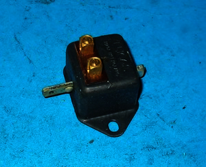

If I wanted to replace the brake light switch on the TC it would either have to be a replica (with all the reliability issues) or a genuine Lucas part from America for a very high price.
This is what the original switch should look like.

The switch could not be any simpler. A wire or spring pulls the contact plate forward and joins the two contacts together.
The system is a simple system, unusual for British design, as they are usually over complicated, causing failures. The Kiss principal of "keep it simple stupid" applies.
