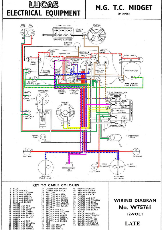

PostPosted: Wed Dec 09, 2020 6:27 pm    Post subject: Reply with quote
THIS is the wiring diagram I shall be using for my TC re wire. The diagram I previously posted is not the right one. Note the voltage regulator RF 95 - although fitted - will not be required as I am fitting a Dynamater with built in voltage regulation. A clearer image can be found here: https://ttypes.org/late-mg-tc-wiring-diagram-in-colour/
With the new harness now mostly fitted to the chassis - I am planning on slowly connecting up what I can until the dashboard becomes available. There are some accessories that do not appear in the wiring diagram and doubtless redundant wires in the loom but I am reluctant to utilise them.
I am trying to ensure that any alterations I make do not compromise a standard layout if at all possible. For example; the wires for the voltage regulator may be needed should the conventional dynamo need to be pressed into service.
I notice how in modern cars the fuses are all lumped together and the same with relays. Would it be a good idea to do similar ?... or should I place relays and fuses close to the accessories ?
I imagine the former plan will require quite a bit of extra wire??

PostPosted: Wed Dec 09, 2020 11:19 pm    Post subject: Reply with quote
Ray,
The terminal that the starter wire is on is only a convenient break on it's way to the starter button and will not show any deflection of the ammeter needle.
Art

Posts: 7318
PostPosted: Thu Dec 10, 2020 1:02 am    Post subject: Reply with quote
Hello Art. Sorry for not getting back to you.
Yes, I watched the video. Someone has spent a lot of time and money on the blue car so it seems strange that they have not invested in the correct braid (pasting lace) which the interior needs. There are a number of other details that could have been done better if only they had contacted the Swallow Register for advice. I am only making an observation not a criticism .
I also saw the video of the maroon and cream car and make the same observation. If anyone needs it there is a trim suppliers near me here in Derby who have reproduced the correct pattern braiding for me. They can produce it in any colour combination on the very same machine that made the original for Swallow Coachworks.
Incidentally, I have the negatives of the cars being made in the Coventry factory. They were taken from a rare album that I restored for Harry Teather many years ago.
About the TC. I am sure you understand electrics far better than me. Please can you elaborate on your comment about the starter wire. I had planned on taking a brown wire from the battery side of the starter switch to 'B' at the ammeter as per the wiring diagram and from there to the panel lights and inspection light sockets.
The 'A' side of the ammeter shows a brown/white wire going to the control box (series windings?) which I presume is no longer correct.
What wire now goes to the up rated ammeter? Is it the 45amp wire from the alternator?

PostPosted: Thu Dec 10, 2020 1:49 am    Post subject: Reply with quote
Ray
Anything connected to the A terminal will show an indication on the Ammeter. It goes to the control box where it distributes power to the headlamp switch, horns etc and routes the dynamo charge back to the battery. The B terminal is from the battery direct and as I said is being used as an distribution point to the map light, the service plug and the starter switch. Any draw on these will not show on the Ammeter.
Art
Posts: 7318
PostPosted: Thu Dec 10, 2020 10:20 am    Post subject: Reply with quote
Thanks Art. That is a clear explanation and should be helpful.
