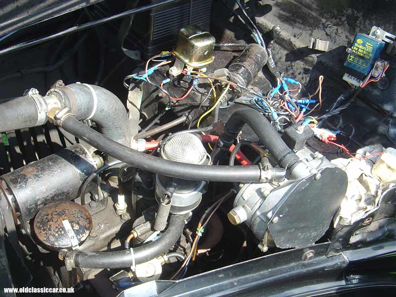

more of a mod than a tip, but we spied this while at Tatton, an LPG conversion on a 103E Pop, thought the sidevalvers here would be interested to see this
