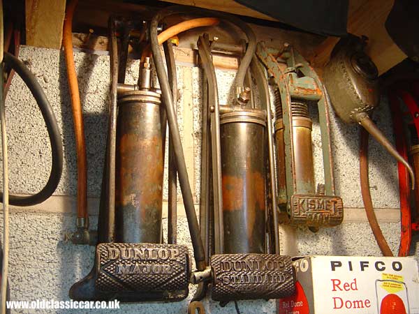

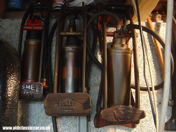

ok you did ask,
firstly, a Kismet Baby, a Dunlop Junior and a W&D foot pump (not heard of this one before)
then the Dunlop Major, a Dunlop Standard and another Kismet Baby, slightly different to the previous one

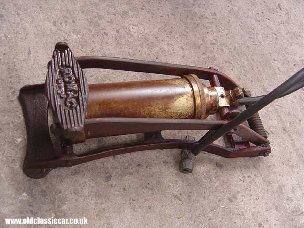

Next a large Romac pump. This one until this morning was seized up completely, and covered in thick black gunge that took some scrubbing to clean off. The main piston was seized, as was the small hinged retaining bracket. With both of these freed up, it works again as it did 80+ years ago

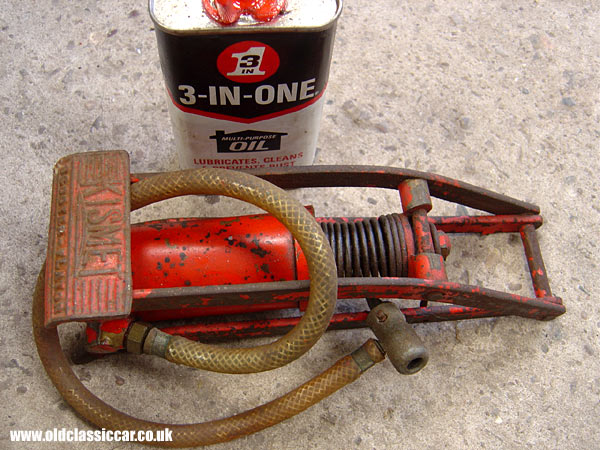

Finally for now, the Kismet Scooter-Flator, shown with a tin of 3-in-1 for scale Smile
