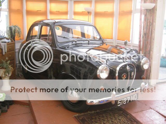

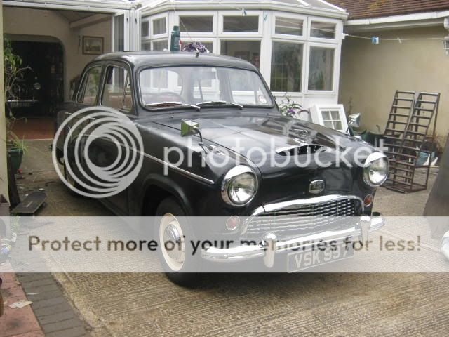

I bought this at the beginning of August, it had a very short MOT but was cheap. Maybe I should have suspected something? Anyway it was very local, drove nicely with a good recon engine and positive column gearchange, the interior had obviously been retrimmed to a good standard at some point and it was just generally a nice old car. So I put in my bid on Ebay, and won it!

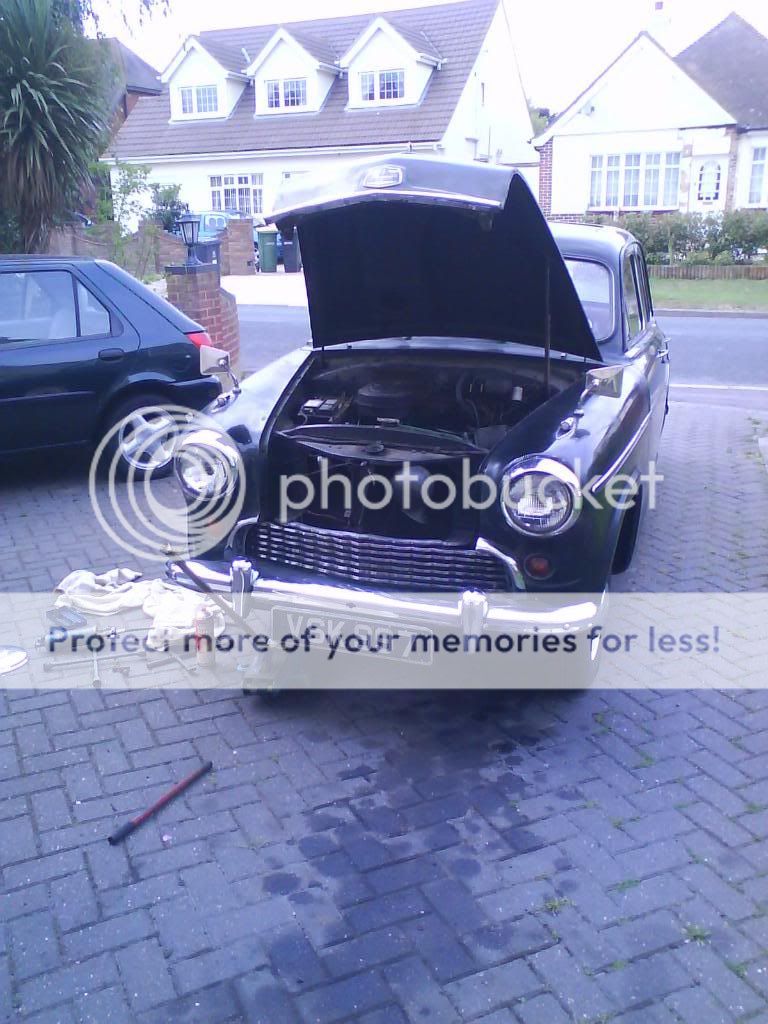

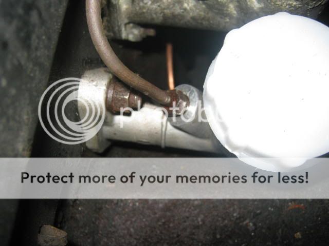

After getting it home, the first problem was the brakes pulled sharply to the left. Further investigation revealed five out of six wheel cylinders were leaking and the (new) shoes were badly contaminated. A phone call to Earlpart and a considerably lighter wallet later and I had new wheel cylinders and shoes all round. We then attempted to bleed the brakes, which blew out the seals on the master cylinder. A new master was swiftly purchased from Ebay:

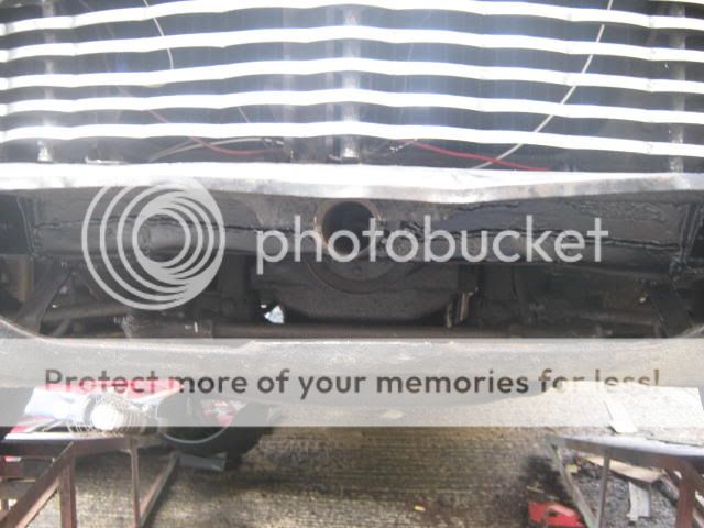

Once all this was sorted out, it was time to turn our attentions to the other MOT items. The wipers were next to useless, so new arms and blades were ordered from Earlpart, the horn not working was eventually traced to some bodged wiring, and the welding...well I'll let the pics do the talking...
This car had obviously been stored outside for a very long time, which had taken its toll. A lot of the welding that was already there looked half decent at first glance, unfortunately it had all been welded over the rust, so most of it had to come out and we started again from scratch.
Started T-cutting and polishing the very faded paint:
Note the new grille, a very lucky Ebay find.
And taken today Very Happy

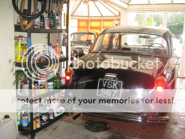

It shares the conservatory with this:
and this:
Hope you like it!

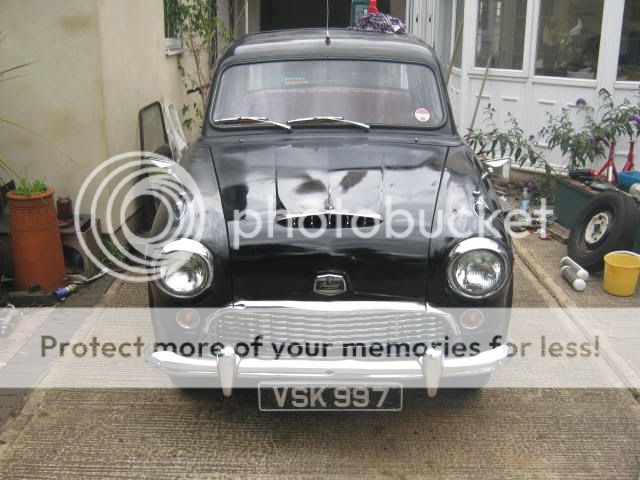

Both front wings are completely rotten, although surprisingly the vulnerable rear wings are like new. Anyway front wings are as rare as hens teeth, a new fibreglass one for the drivers side came with the car so I will buy a matching one for the passenger side and these will then be fitted. There's also some rot in the passenger door to sort out, and at least a partial respray as the paint (on the roof in particular) is very crazed indeed.

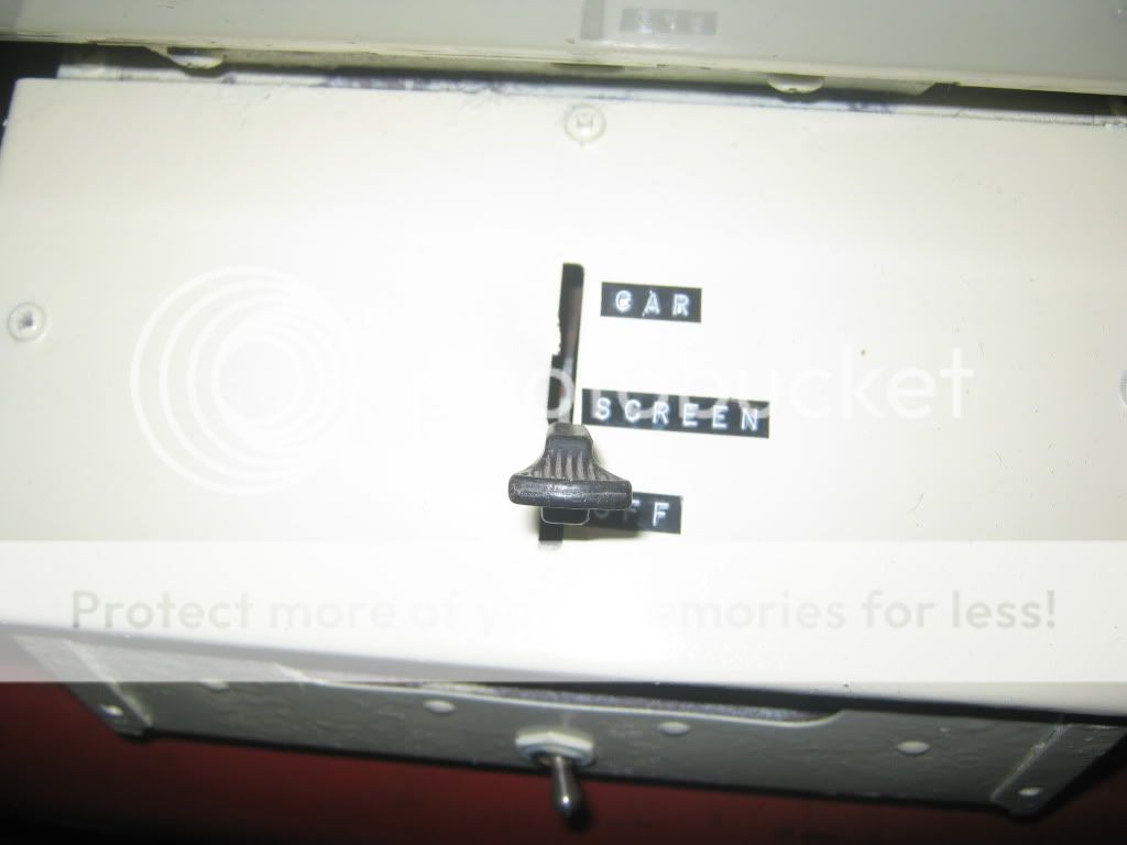

One job that needed doing before the winter was sorting out the heater, it had never worked and I realised the matrix must be clogged Sad
Unfortunately on these cars it's hidden away right up behind the dashboard and is totally inaccessible, I managed to get the hose pipe on and loads of muck came out, but still no heat would come through.
Luckily my dad had a brainwave, an old rusty Morris Minor heater from the depths of the garage, past experience has told us these are amazingly powerful and streets ahead of the 1950's Austin heaters. So a few coats of some 2CV Custard aerosol paint to match the dashboard, some rerouted pipes and wires and a bit of "dymotape" and I now have a half decent heater!
I think it looks rather neat. My dad also cut out all the rot from the top of the O/S front wing and welded in a huge repair section roughly 1' square, cheers dad!
