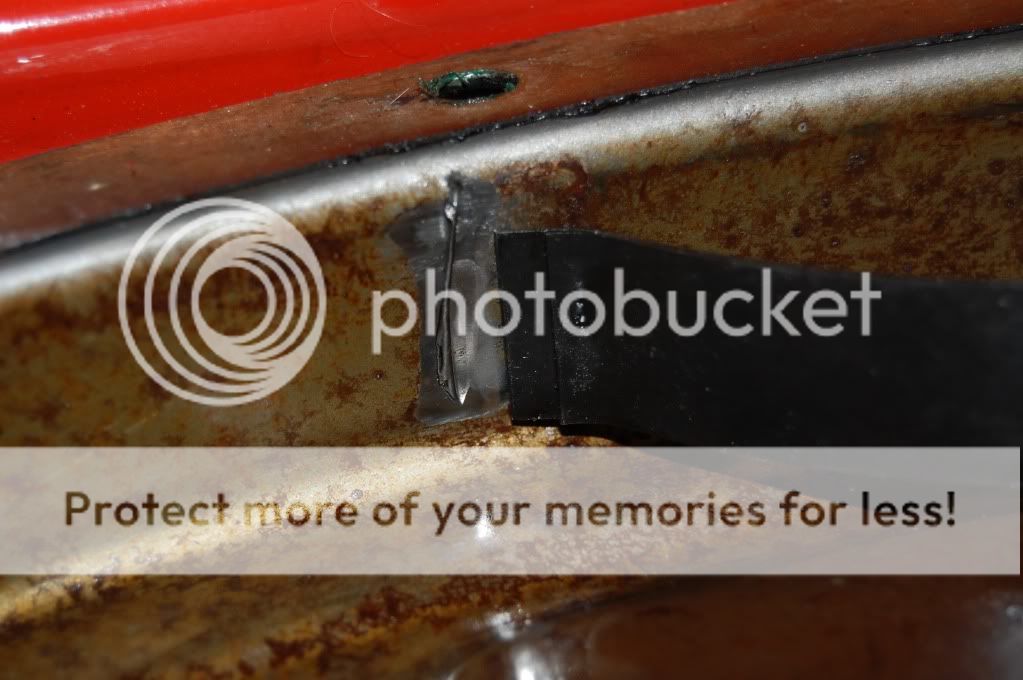

Less than a year ago I did a lot of work to the Midget engine including a new timing chain and tensioner. Recently a have heard a clattering sound from the front of the engine. The only thing that can clatter in the front of the engine is the timing chain Confused . Today I whipped the radiator and cover off and this is what I found;
The replacement tensioner has a sharp end to it that has worn a lip into the case and jammed itself into it. Just peachy, as if I don't have enough to do.

Something else wrong there Nic, besides the sharp edge. The spring blade should contact the cover about the centre of the radiused part NEAR the end. The sharp bit, which probably is rubbish, should not have been able to contact the cover. Are you sure it WAS the correct part?

I have an original tensioner and it is the same profile. I guess that if it had a radius on the end and it wore through one could have a piece of metal floating around ones engine. Sad I went through MGOC's stock of tensioners and they all were the same so they are returning them. They gave me a second hand - but good case and a new oil seal and gasket. I smoothed the end of the tensioner with my oil stone and a little radius on the edges. I got the case sand blasted on my way home, painted it then went to invigulate an exam, when I got back it was dry. It all went back together easily and I drove it to work this morning. Very Happy When I drained the anti freeze I was suprised to see how much crud there was in it as I had flushed and replaced it only a year ago.
