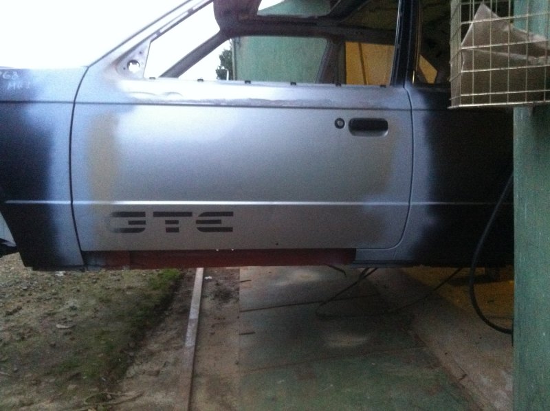

I'm having a real nightmare with panel gaps Sad
4 hours with a mate the other day and we got both the wing to door and door to rear quarter perfectly gapped.
However, I had to raise the a-pillar to open the gap at the bottom of the door to the rear quarter right.
Now, of coarse, the bottom of the door has a bigger gap between it and the sill at the front.
My question is: can a door gap be fixed with the use of a quality high-build primer!? For example, close the gap as the top to match the gap at the bottom?
It's causing me to lose sleep as this thing might end up in the skip after a year of work.
It's as if the body has sagged the wrong way - i.e. the front and back have sagged down like it's been supported only in the middle like a see-saw.
It doesn't help that I've also replaced the rear quarters but there's no ambiguity with he rear quarter as there are so many points where it meets the shell.
This is where I've got to, I had to raise the A-Pillar about 4mm to get this, the problem is the lower rear of the door.

Remember, though, that the quality of replacement panels is not always all it could be.
I'm working on a Sportshatch, I've had numerous issues, more trouble when using NOS panels than with bits I've made. I used a section of a rear quarter to repair part of the window frame, although it's on right the swages don't line up. I spent some time worrying whether I've put the door pillar in the right place because I couldn't make the NOS front wing line up, only to be relieved when I tried the old rusty one and it's spot on. Doors vary in size by quite some distance. I've spent the last two days splitting the two halves of the NOS back panel because whoever spot welded it together back in the day didn't do it properly.
There's a school of thought that the main reason NOS panels are around for cars of this age is because they were ordered up for a repair when the cars were newer, found to not fit properly, stuck on one side and a replacement ordered. Fast forward twenty or thirty years, the ones they threw on one side are suddenly NOS ex-dealer genuine panels.
I doubt you'd get much help from high-build primer, I've seen (on American Hotrod, though) people building the gap up with filler to get it right, though that always strikes me as too fragile especially for a door bottom. I've got quite a wide gap across the bottom of the door and if I can't live with it I might weld a strip of steel along the top of the sill to close it up. Doubt it though, it's a seventies Vauxhall after all.
Posts: 2727
PostPosted: Wed Aug 08, 2012 10:39 am    Post subject: Reply with quote
Also, did you post the right picture? Lower rear of door doesn't look too bad to me, hard to judge the rest without the sill in place.
Overall that looks like a nice even gap, I guess it depends on your expectation. There's a chap I see at shows with a white Mk1 GTE that he's restored, I'll have a look at that next time I see it, probably Tatton weekend after next.
What I was really getting at above was that you might have to adjust some of these panels, and it's not necessarily a sign of anything terrible.

Yeah, that's the right pic, that was taken after the 4 hours of sweat and tears but as you can see, no sill.
I went back this afternoon for a few hours and managed to get a pretty good fit.
I like the welder wire trick too!
Here's what I ended up with. Pretty happy in the end - a few areas might need a fine skim with filler to be perfect.
