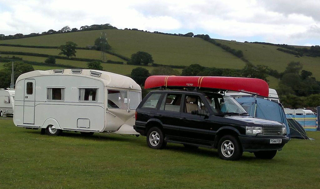

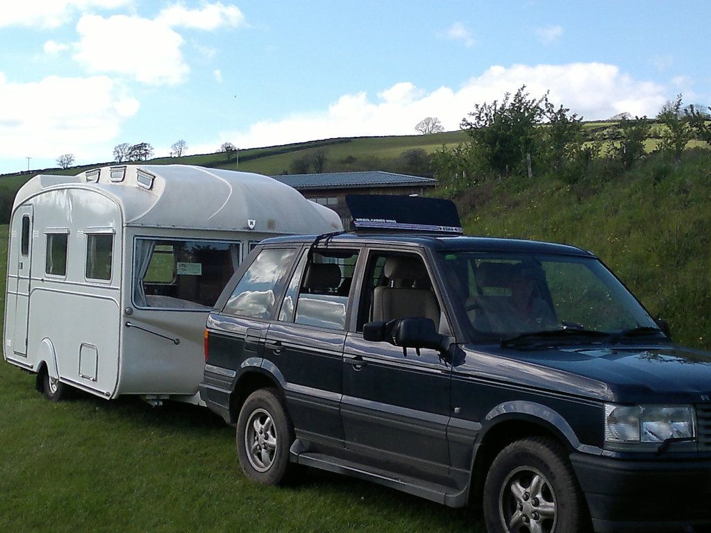

Well certainly love towing with the Windslammer on the roof this weekend.
Surprisingly a new type caravanner didn't know what it was so I told him they were all the rage back in the early 80's and everybody had them!
I also love towing with the canoe on the roof as it performs the same job as the Windslammer. No flies on the front windows and the whole outfit glides through the air whilst traveling. A pound worth spent off Ebay (for the Windslammer I must add, the canoe was quite a bit more than that!)
