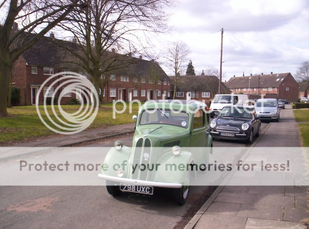

Hi everyone. Big apologies for not posting for a long while, virtually all the posts concern this young man :
His name is Bertie of course He`s a 1958 Ford Popular, his name came from a car my Dad had, a Morris 8 type `E` called Gertie so it`s in keeping Very Happy Well, he`s had a long lay-off due to various reasons, passed his MoT in april with no problems and of course that will be his last. The problems started as I took him out and about.. we`d go for a while then he`d stutter and stop. Fuel starvation of course, it`s very common with Pops and there are various cures. Heat shields are now fitted surrounding the mechanical fuel pump but with an opening at the front for cooler air to circulate round it, and also underneath the carburetter to protect both from the heat from the exhaust manifold and down pipe. So far so good, but me being me I`d rather be sure as he`s got The Festival of Motoring`s 50 mile run a week tomorrow ( 26th August ) at the NAC in Stoneleigh and breaking down is not an option Laughing This is the existing fuel pump which failed a while ago :

Here he is ready to undergo the run two years ago - it was cancelled last year- and he completed the 61 mile run faultlessly in very wet conditions. It`s a 50 mile run this year, and fingers crossed, he`ll do it again in appropriate style. I look forward to posting the outcome in just over a week. Thanks for reading this drivel, wish us luck! Very Happy

What a lovely wee unmolested Pop. Too many of these have been converted to all sorts. Much better in original condition. Cool
