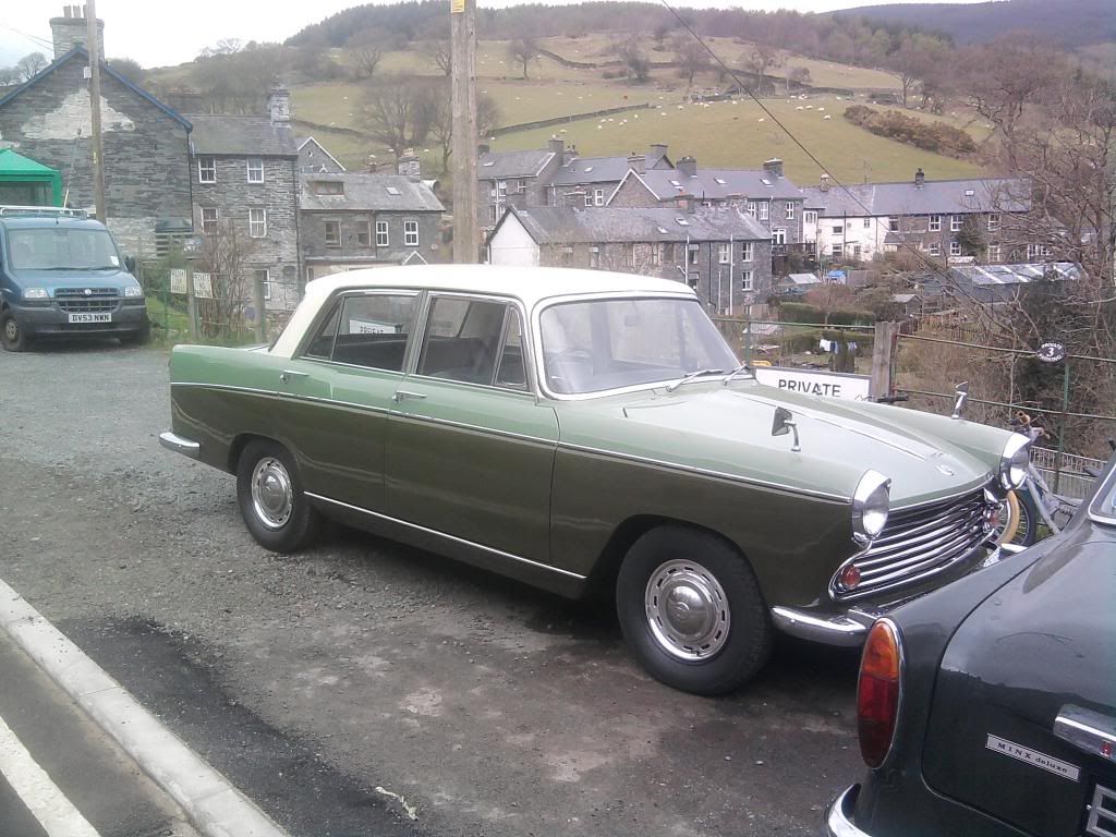

me and my wife drive classics every day i drive a 63 morris oxford and my wife drives a 65 hillman minx deluxe .

nice Merc..nice Minx...nice Oxford....I keep mine on the road but dont use it much in the winter because of the road salt.
