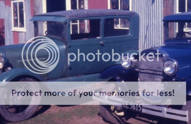

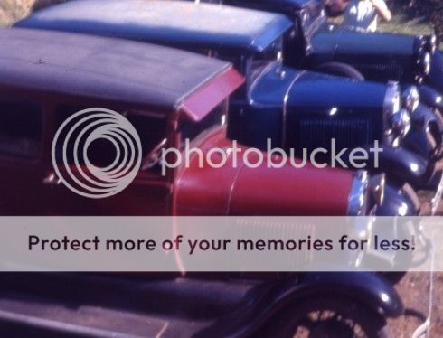

While all this was going on Bill and I started some serious hunting for A's as we were both convinced that they were an excellent car to own and use. Unfortunately I can't find a good photo of the car mentioned above, but it appears in this photo as the second from the left.
The darker blue 1931 car is one that Bill bought with a damaged gearbox and set about restoring, the red utility I bought to re-sell, the grey utility was an early 1928 that I bought (probably built 1927) with a right-hand handbrake lever and the orange one was also Bill's.
As you can see we had been busy collecting. My car was the only one between us that had a tow bar, and Bill got interested in Dodge cars, so a couple of times I used my machine to drag the trailer with a complete Dodge on the back. Incidentally, the A had a very growly gearbox, and one day I decided to take the top off the box. Second gear was so worn that the teeth were sharpened to points. I put the top back on and decided that when the gearbox finally died, I would fit one from another car. Well that gearbox kept going and was still in the car when I sold it.

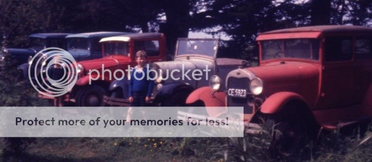

At that time there were about 7 or 8 A's (unrestored) in everyday use in Wanganui, with a population of about 35,000 people. New cars were very hard to get so a large number of cars from the later 1930's and 40's were very much in evidence.
I tried to find A's, in the hope of coming across a real gem, but also because I could buy one, perhaps off a farm, for £25 or £30, get it going and ready to re-register and sell it for £50. I can't remember how many I dealt with but it would have been about a dozen or so, and Bill did the same thing with similar numbers. We never found a car that had a broken crankshaft, although we came across some interesting non-original fittings from time to time.

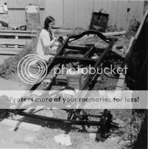

In 1969 I took my new wife to N.Z. and was reunited with the '28 Tudor. It immediately became our regular transport, used for work and trips, including a few 100 mile plus excursions. In 1971 plans for the International Vintage Car Rally were being set in motion. My wife and I decided that we would like to go on the rally, but in those days a car needed to be restored to a fairly high standard to be allowed entry. We had little money, but a lot of enthusiasm, and my wife, Noreen, worked diligently on the project with me. We did as much as we could ourselves, even things that neither of us had any experience of like the upholstery.
The car was pulled apart. I did nothing to the diff as I deemed it in good order. I checked the gearbox, but again it was in good order so I did not take it apart. I sent the engine away to be re-bored to suit the size of the smallest of a 'set' of pistons. The pistons were second hand and out of a couple of different motors, but they were all of the same pattern even though of slightly different sizes. The re-bore company also gave the crankshaft a light grind (.050 if I remember) and cast new babbit in the mains and rods. I managed to buy from Australia N.O.S. valve guides and gudgeon pins as well as king pins and bushes and some other odds and ends. When it came to assembling the engine, I hand-scraped all of the big-ends first and got them fitting nicely, then set about the mains. In the latter stages of the assembling, a club member who was an auto apprentice came along with 'plastigauge' and checked my bearings. They were all within tolerance which pleased me no end.
I fitted good second-hand valves, checking that all were non-magnetic (supposedly the better steel), and the new valve guides. The valve seats were re-cut and the valves faced, then I lapped them in. I used a set of butcher's scales to 'balance' the piston/rod assemblies by laying the rod end on a knife edge and the piston on the scales. The lightest one was my 'master' and all the others had a little metal taken from inside the skirts until they all weighed the same. A similar trick was done by laying the piston on the knife-edge and weighing the big-ends.
The top of the block was skimmed for true as was the cylinder head, and of course a new copper/asbestos head gasket. I can't remember fitting new camshaft bearings, and I know the camshaft itself was untouched apart from removal and replacing it within the block. I toyed with the idea of doing something about the original multi-plate clutch, but in the end just assembled it into car again as it was.
