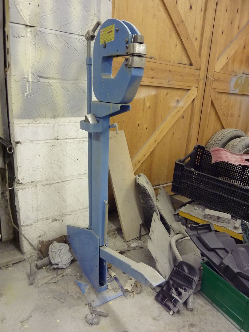

I use one of these for shrinking and stretching, the jaws swap depending on what you want to do. Quite easy to use, and with a bit of practice you can get very accurate curves. The metal does need finishing afterwards as the jaws mark the metal.
Mine is a floor mounted foot jobbie, but you can get smaller bench version that sits in a vice.

My body restoring friend has a free standing type as in the photo made by Eckold and also has an older one of these in the link.
http://www.youtube.com/watch?v=Em04KY0tSxw
It's the tooling that cost a fortune, but worth it if you use it daily as my friend does.

I've got a smaller version of that, it's rated as "up to 18swg" and it will shrink that, but it's happier with 20. Mine came as a pair off an eBay seller, new shrinker and stretcher with two bodies and two handles for just under £100, so it's worth keeping an eye open. These are the bench mounting ones, I've got a steel frame trolley so I've mounted them on that. It is possible to do a lot of shrinking with a hammer and a lot of practice, but I never mastered the technique and it's very much easier with the tool.
