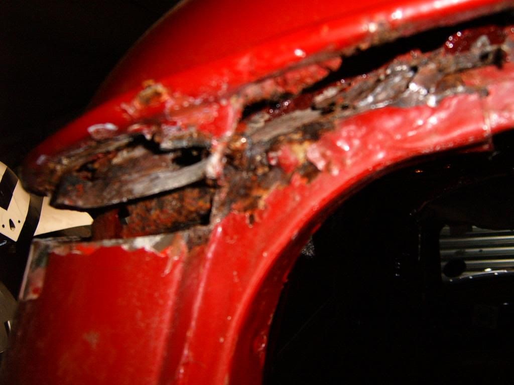

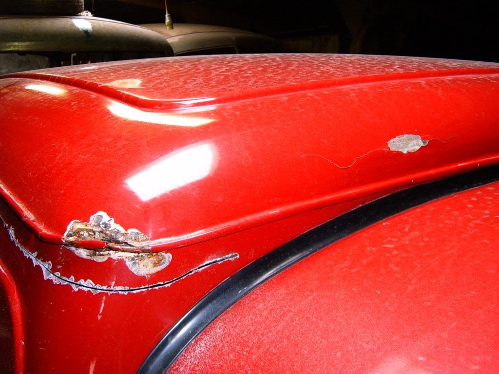

This is the first one I did a few years back. It had been bodged and plated over on the inside, so I cut through the body about 1" down from the guttering all round.
cheers
