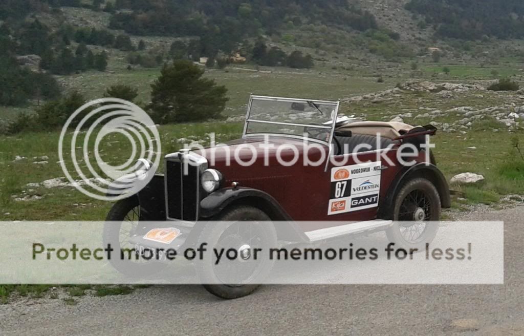

PostPosted: Mon May 27, 2013 11:09 am    Post subject: Reply with quote
Hi Rick,
Sorry for late reply, the weekend was blocked by he family. Saw the photo's of your saloon on the forum, nice car!
Here is my tourer somewhere in France during the 'Tulpenallye'
Thanks for the tip, I will try the prewarminor forum.
Regards,
Eric [img][/img]
Posts: 22780
PostPosted: Mon May 27, 2013 6:50 pm    Post subject: Reply with quote
*Cracking little car Smile
(* = very nice)
