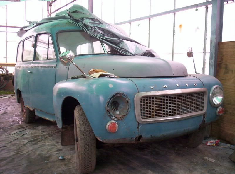

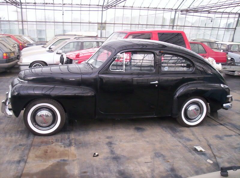

Over the next few months (years?) i will be helping a friend restore one of only 3 known Volvo PV445's in the U.K.
Ray has collected many parts in preperation...he has a PV444 so we have a "reference vehicle"
The PV will need quite a bit of welding and we hope to finish it so that it can be shown next year...a few other vehicles may get in the way though (at the moment i have 7 "projects" and Ray has more)
And heres Rays PV444

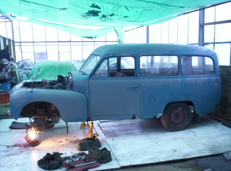

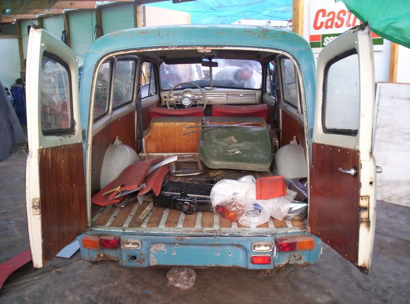

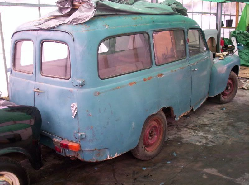

The time has come to pull out a project thats been sitting on the back boiler for 6 months and has been passed from owner to owner for 10 years...we have all the panels...a new engine and 99% of the bits to finish it...including a genuine roof rack Cool . The plan is to have it ready for summer and drive it to the Volvo nationals in Sweden...this could be one of teh most exciting projects to date Very Happy
Jan 12th 2008
I spent the whole day clearing a space for the Volvo...and i'm ready to start tomorrow Cool ..more pics..

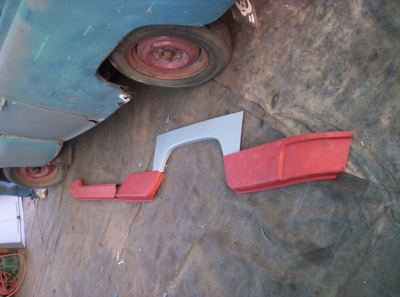

Whats got to go onto...this is one side...the other is the same...the panels look to be excellent!

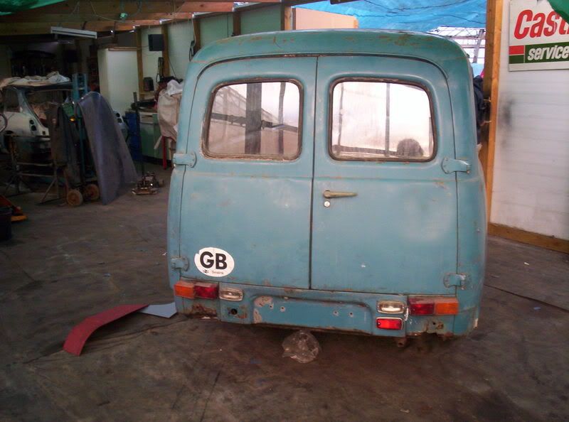

The sexy rear...

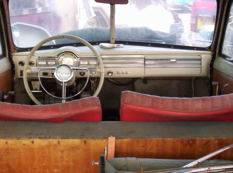

And the sexy inside...
the view from the rear seats....

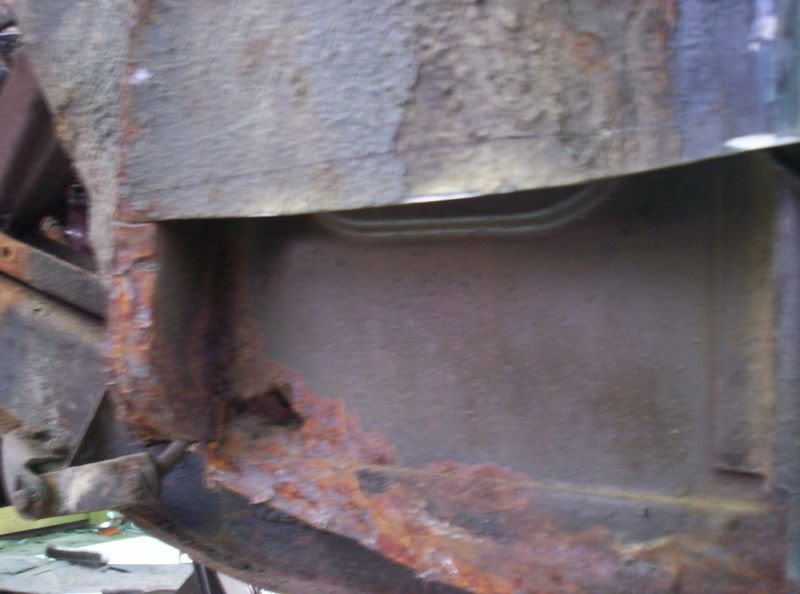

theres signs that the car had ben repaired in the past...there are 2 innerwings ..trapping the rust inbetween

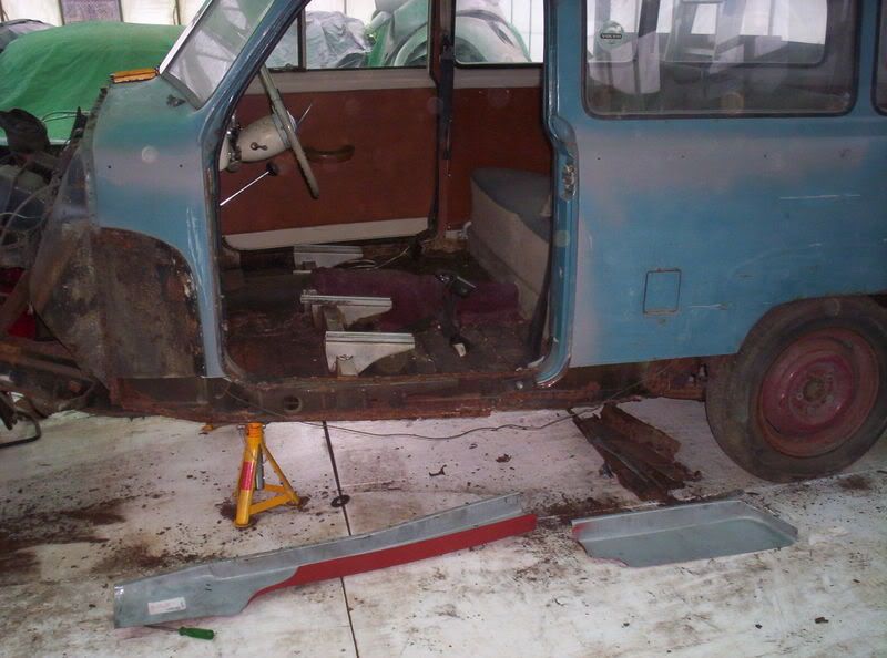

small patches will be required in a few places...heres the front of the inner sill
wing and front panel off...most of the nuts had siezed and sheared off..most were captive so will need replacing.

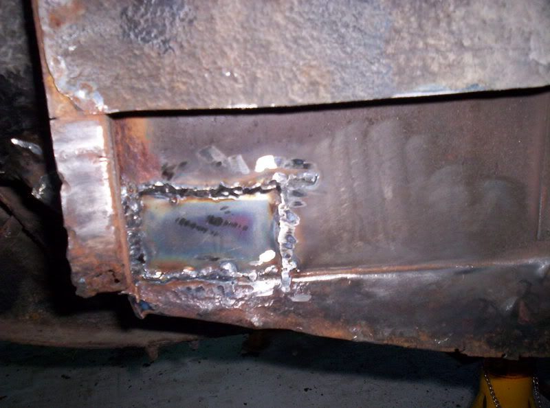

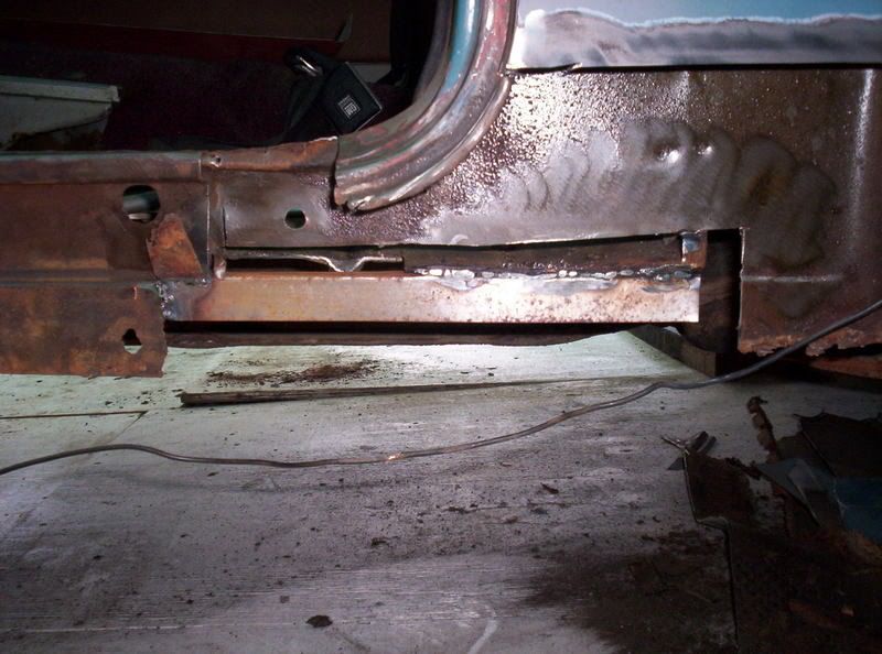

I started by welding up a small patch near the lower seat belt anchor point...the floor and sill have rotted in this area and the inner sill needed replacing for the last 60cm.....
A small patch was needed at the front of the inner sill just where its meets the baulkhead..
In order to determin where the inner sill ends at the rear i needed to retro fit all of the panels so the rot was cut back to good metal...the edges stepped with a joggler and the panels held in place with self tapping screws...
Heres the sill, wheel arch and intermediate part in place....

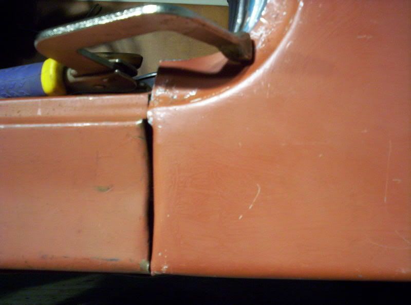

generally the panels are a good fit only needing a small cut or bend but the intermediate piece was poorly finished where it meets the end of the outer sill..this will need a bit of work to get a satisfactory fit...but thats where i finished for the day!

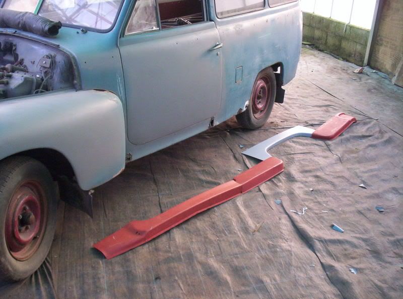

First job of the day was to remake the middle section so that it meets up with the sill...i had to cut the panel and reform the corner...this was done on a vice and using a rounded chisel to create the fold.
Next on the list was to determin where the inner sill finishes...this was done by screwing all of the panels into place and making cardboard templates...then cutting the panel out of sheet steel and welding it in place.
The front sill was then welded into place...first by tacking it...checking the door shut lines then welding everything into place.
Job 4 of the day was one i wasn't looking forward to and that was making the rear inner wheel arch..i had a few lengths of pre-folded steel and by cutting into the steel and holding it against the outer wheel arch with mole grips and welding clamps the panel was formed...when everything was cut and folded the cut-outs were welded back up.
With the inner wheel arch repair panel held in place it was tacked..checked by holding the outer panel over it and then welded into place...the welds were difficult because no matter how much i cleaned the steel there was something in it or on it that reacted and the welds ended up blobby...so progress was slow.

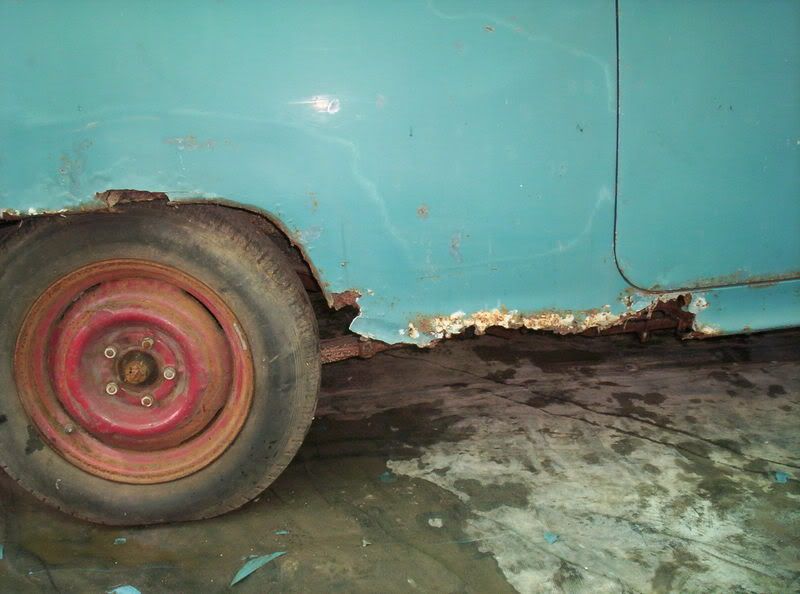

It seemelike i got nowhere fast today and a small hole in the rear deck turned out into a large repair.

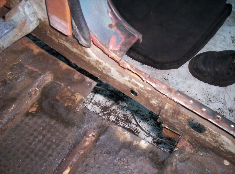

There was daylight comming through the wheel arch and there was signs of an old repair rotting again (this is what happens when the rot is covered rather than cutting it out)..this was above the rotten out rigger so i decided to cut it out for 2 reasons...first to repair it and second was for better access to the top or the inner sill panel and the new outrigger...
I welded the inner sill panel in then made a new outrigger section..
and welded it into place....

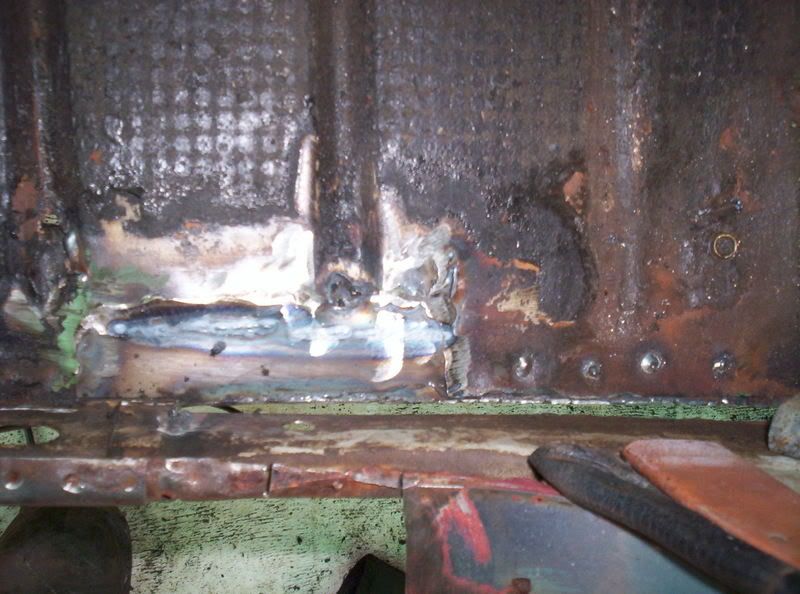

How about this for a bit of forward planning...Volvo left a string of holes along the top of every outrigger and box section...then filled the holes with a rubber bung...just right for injecting wax-oil...it's just a shame no one ever made use of them......
I have cut the panel to close the floor back up and it has ribs to match the existing ribs in the floor...hopefully i will be able to finish this corner in the next day or two.

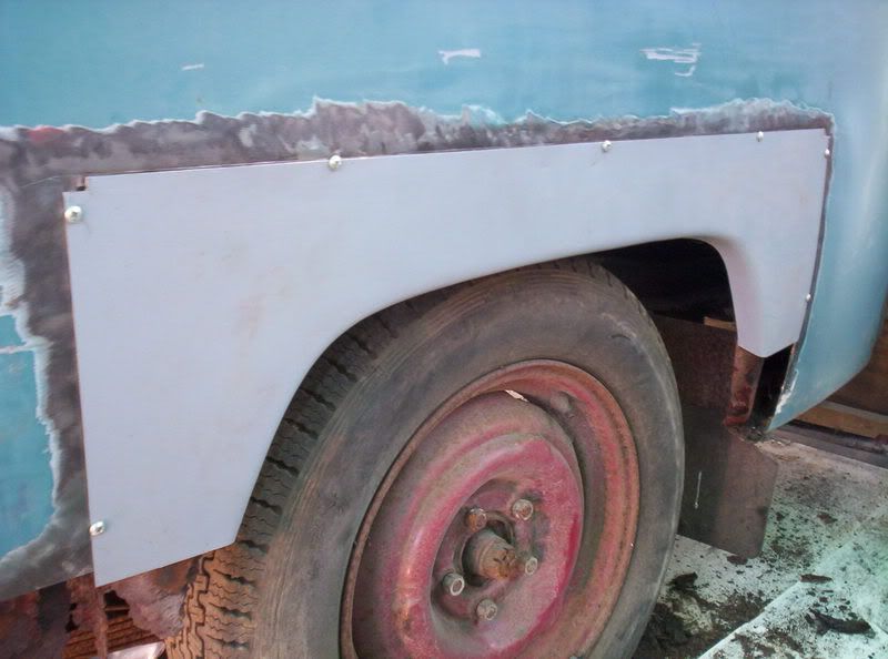

The wheel arch was a bit frilly around the edges so i mad a repair panel ...using the outer skin as a template...i will do the rear later but so far the repair is clean and solid..i also had to add a new lower inner edge so that the new sill has something to hold onto...from this..

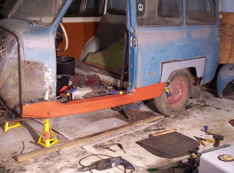

All of the front lower edge repaired it was time to fit the front sill section...
then the centre sill section...

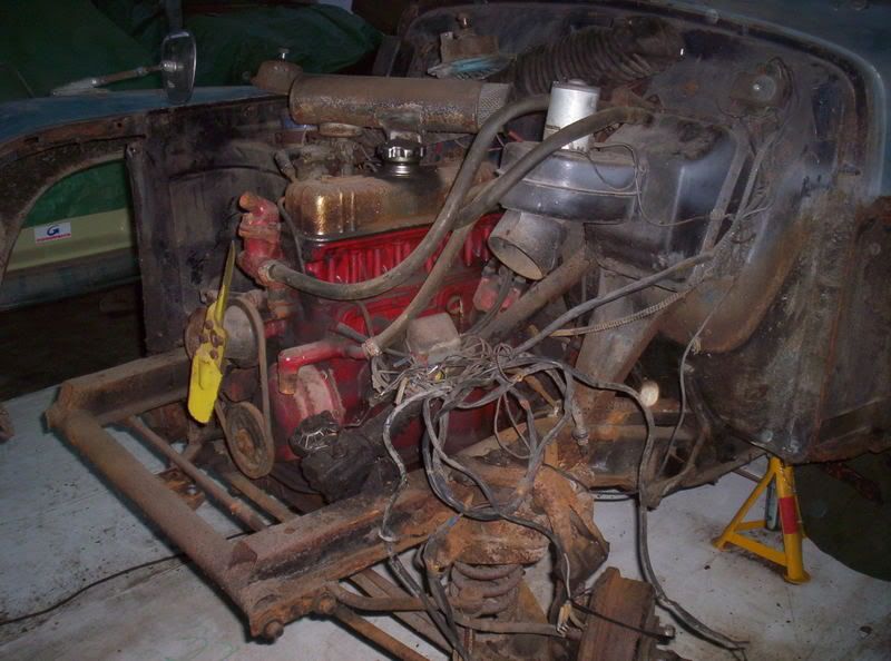

The engine is out and stripped..it had a siezed piston, that was given a gentle tap...i'm not sure yet if Ray wants to buy 2nd hand or renew the existing engine
