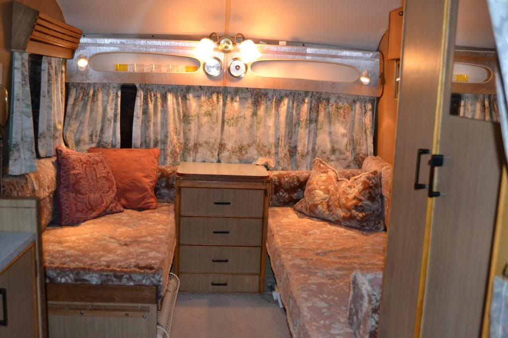

We plumped for a Cheltenham Sable in the end, and here are a few pics of the interior.

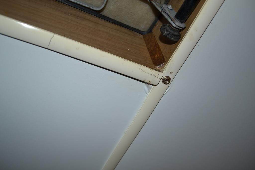

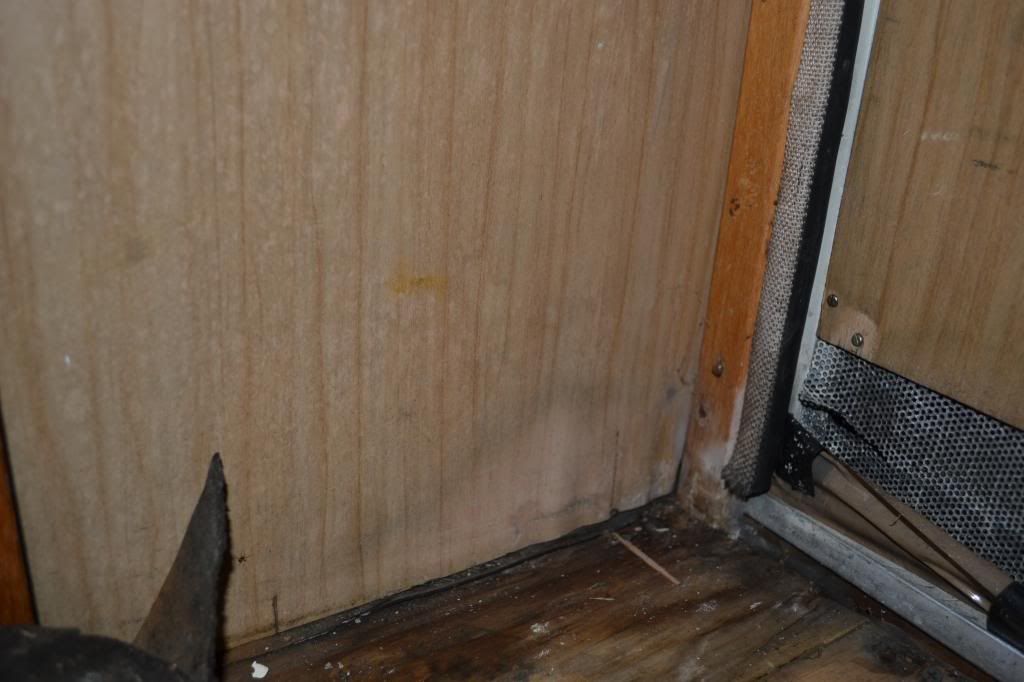

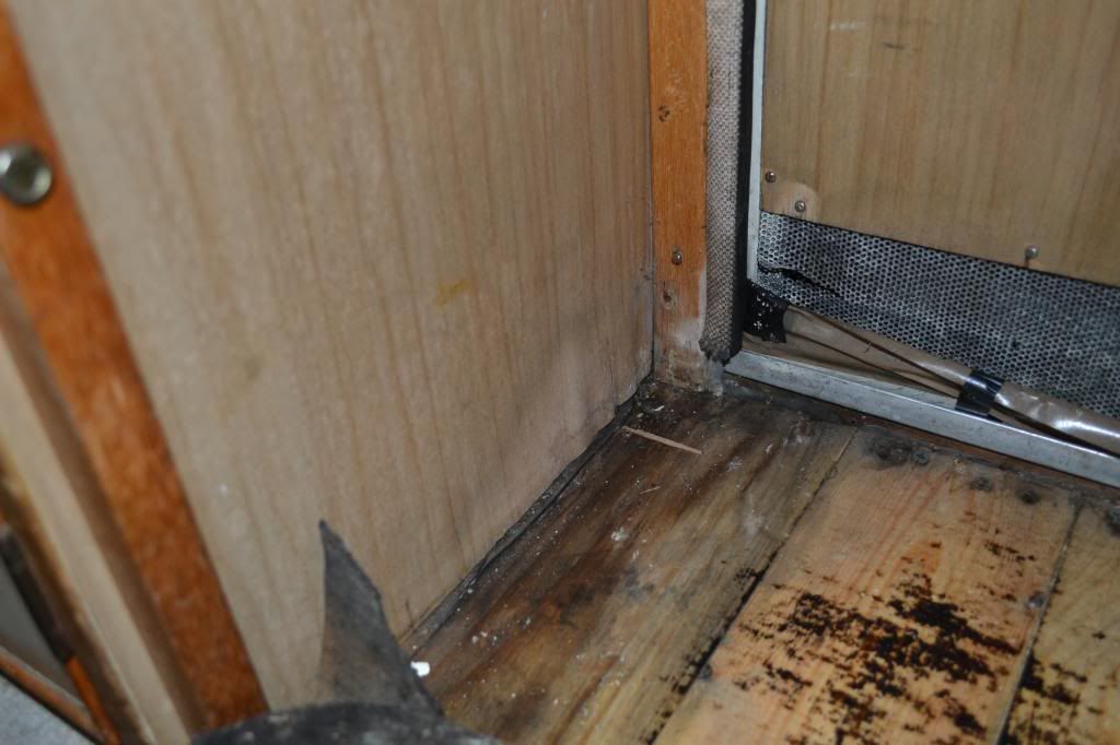

The interior seems to be in reasonable condition throughout, but we have found some damp on the floor and into the units at one of the doors and there are various bits of damage around the roof beads.

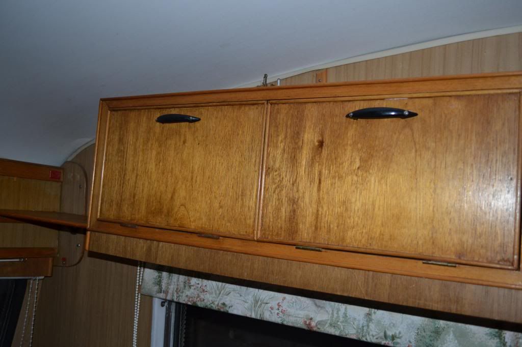

We are debating what we should do with the interior wood because there seems to have been lots of additions of odd handles and modernisations over the years, so may not be original enough to warrant restoration. I have been searching online but without a great deal of luck so am hoping you might be able to answer some of my questions.
If we were to try to replace any of the wood panels, does anyone know a good stockist of suitable ply?
Does anyone know if the different colours in the cupboards were part of the original design or whether there have been changes made - the back cupboards are two tone and the side cupboards are all one colour... not sure why........
Damage to ceiling around beads.... any ideas how we could fix this without making it look worse and also where we could get replacement beads?
Water damage at the door..........

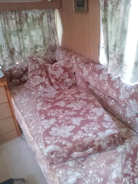

And really sorry for this question..... but where does this cushion go? Can't work out where it lives!!!

With those handles I would expect you originally to have had photoprinted plastic interior wood, not varnished wood veneered ply.
That cushion - is it not the one that goes on the extended part of the left hand settee when extended into a single bed?

| Thanks Uncle Alec, yes that seems the case that some of the interior is not wood....we were just confused as some is. The cushion does fit on the bed extension....but where does it live the rest of the time? |

Thanks for all the information. We will do as suggested wilson294 and strip the bead to see if there is more work to be done. Fingers crossed.

Still not sure where the cushion goes when not a bed!! |

The spare cushion is to extend the short bed on the left. There should be a matching wooden panel that fits across the aisle to act as a support. The beds are then made up across the caravan. You will see where the cushion fits then. _________________ Evans Waterless Coolants

Posted: Wed Jan 16, 2013 1:48 pm Post subject: |
| But where does it go when not a bed?? |

Posted: Wed Jan 16, 2013 3:05 pm Post subject: |
Ah, that is the mystery. I remade all the upholstery and didn't have the cushion that you have, so made it in two pieces as armrests. See them at the front of the van in this thread..
http://www.scimitarweb.co.uk/sgwrs/viewtopic.php?f=10&t=12550&start=15
Ah, looking again at your picture, you seem to already have them, unless they are not cushions in yours and just backrests?
I still have the set of original cushions, backrests and covers in storage if anyone wants them? _________________ Evans Waterless Coolants
