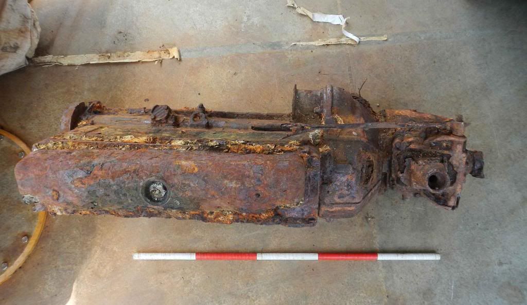

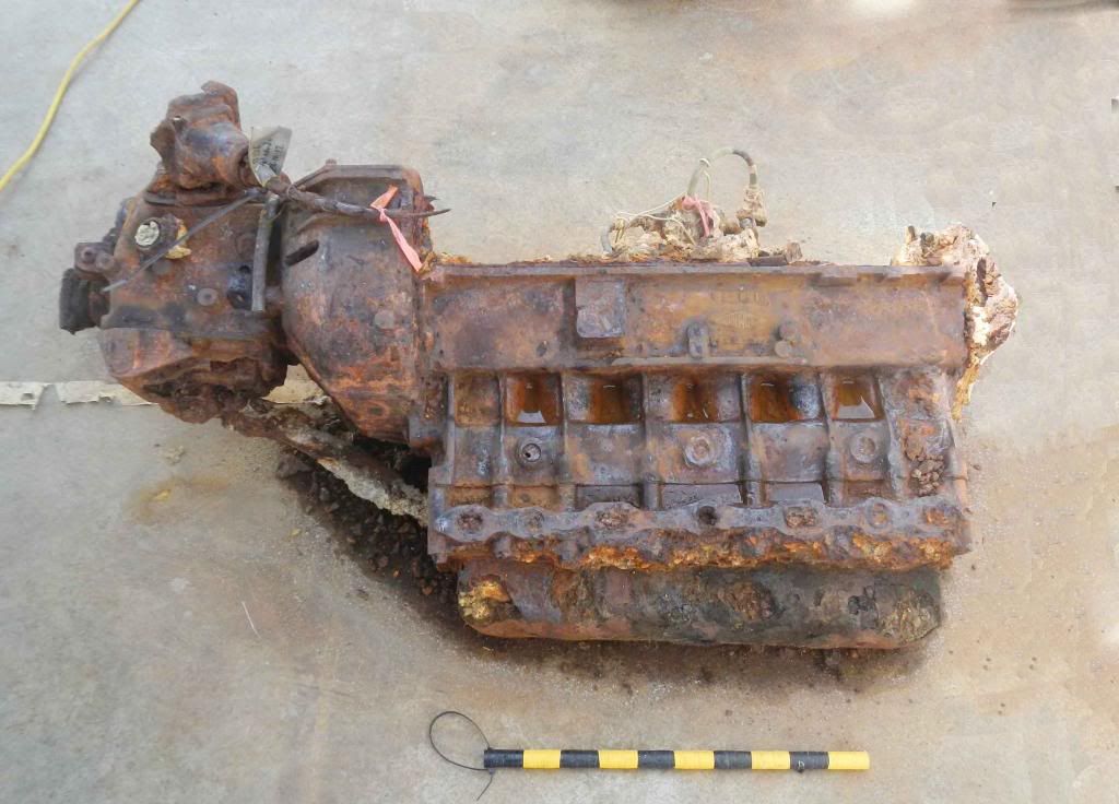

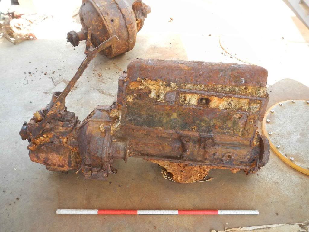

I'm an archaeologist currently working on a bunch of WWII military equipment dumped in Darwin Harbour, Australia and I was wondering if anyone may be able to help me identify this engine block?
It's a six cylinder inline petrol [I think?] with gear box and hand brake lever still attached. It's in pretty bad shape after being in the water for so many years, but visible markings include "CHROMIDIUM" "85912125" [?] and "12E' on the engine housing, "RJHUNT" "1027802" and "2" on the gear box, "918695" above the fuel pump and "27" between fuel pump and timing cover.
Based on the RJHUNT and CHROMIDIUM stamps, I'm thinking it might be a Morris Commercial? But I am by no means sure. I was wondering if anyone may be able to help out? Or tell me if I'm on completely the wrong track!

Hi Caroline,
I have sectioned drawings of the Morris Commercial NVS/FVS 1950-53
and the gearbox/brake lever does look very similar. The engine has the starter and distributor drive in similar positions and the ports on the other side, although my drawing shows all the ports with square cross section and differently disposed. Perhaps they modified the head design. My drawing also has the oil filler further forward than in your photos but that too might be a later mod.

Thank you so much for your reply. Based on your description it sounds like I might just be on the right track! Based on the context and other artefacts we've been finding, I'm thinking that this engine most likely dates to the 1930s so perhaps the differences are, as you say, due to later modifications.

If it is a Morris engine (which I doubt as it looks more like a GM type bellhousing/gearbox) it will be post war.

Yes Rick, I worked on most post war Morris Commercials. They didn't have an OHV engine until around 1950. That engine seems to have a tin tappet side cover like GM products and the bell housing is pure GM/Bedford where you remove the clutch through the bottom. Maybe from a Chevrolet truck, though I could well be wrong of course, it has been known......... many times:?

Ok so I can pretty much rule out Morris, that's good to know, thank you Smile It was an amateur guess on my behalf due largely to the RJHunt logo. I still don't know what that is, but I've also ever seen it mentioned in connection with Morris engines. From what I've learned recently, Bedford and Chevy engines were often very similar - is that right?

I was looking at the possible side cover too, it's similar to that on my Bedford ute (although its engine is smaller overall).

Bedford and Chevy engines were so similar, my first American car was a '49 Chevy fitted with a 214 cubic inch Bedford engine. The engines were so similar the Chevy carb manifold and distributor bolted straight onto the Bedford block.
I believe the Australian army used a great many C.M.P. Chevy trucks.
Two big differences between Chevy and Bedford are Bedfords used shell bearings on the big ends Chevy's were white metal. Chevy's used cast iron pistons and most Bedfords used aluminium ones

I might see if we can pull apart one of the engines to have a better look at it [if it survives].
I've also been looking into CMP trucks more now after reading your comment and I'm starting to think we may also have some Ford built CMPs. Nice one!

Caroline, the Chevrolet CMP had the 6 cylinder engine whereas the Fords had the Ford flat-head (side valve) V8.
I would expect that despite the length of time of immersion, some of the heavier steel and mechanical parts would survive enough to be identified. Things such as the two diffs and axles, transfer case and gearbox, chassis frame, springs etc., and even the front bumper bar.

C.M.P. trucks were built to British government spec which meant Ford and Chevy bodies were virtually the same, although they did vary over the years. I think the early ones had a reverse sloping windshield, the later ones had a more conventional windshield and a roomier cab. I can't confirm that, someone borrowed my book on military vehicles and it never came back.
Apart from the engines the axles were different between a Ford and a Chevy, Chevys had a banjo type axle.
