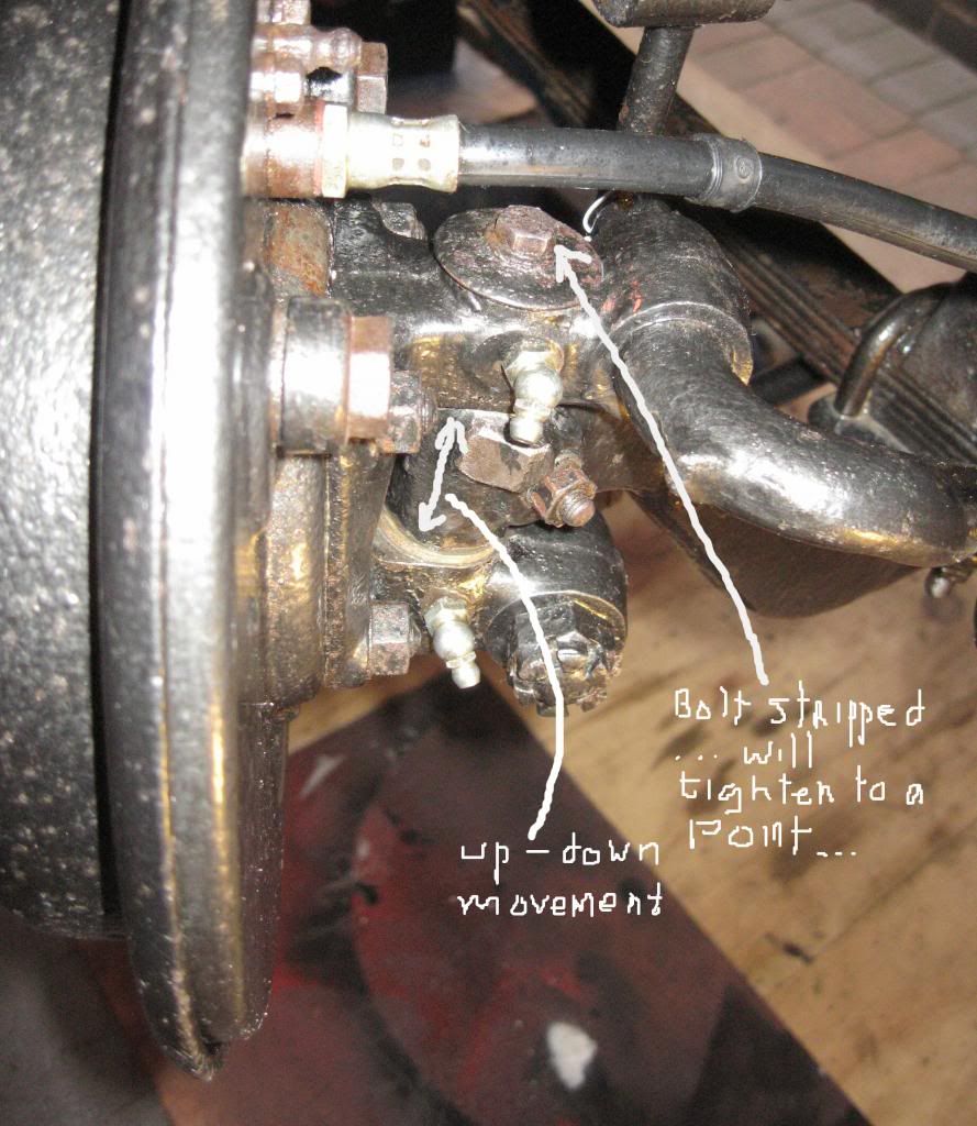

Hi. I have the car up on the ramp for winter for a good old going over underneath, taking it slowly and working corner to corner.....got to the drivers side front corner this morning and found a problem
The up and down movement at the swivel pin joint to the steering knuckle is severe.....not mentioned in my recent MOT and he did set about it with levers with gusto. Anyway, I have attached a picture of the offending area and marked where the up and down movement is...so much so that when levered up, the bottom thrust washer is free to turn. Also the top bolt(marked), which locates the swivel pin appears to be stripped....it will tighted to a point but then slips over. It will unscrew out though and is in one piece.
I am guessing that the top bolt is not supposed to squeeze the location lugs of the steering knuckle to make good this movement.....its size suggests that. So if there is that much free play, is there a spacer missing or is the bottom spacer worn....... is this a normal wear point. My experience with king pin type joints is that wear causes lateral movement not vertical.
I do have a workshop manual, but it is so simplistic that as handy as I am....I couln't tackle this repair without some guidance.....anyone had experience of this please.
Stuart

Hi again. As I sat writing the previous reply to myself I thought....'I havnt yet checked that the passenger side had one or two thrust washers fitted'. I have just been out and can confirm it has TWO....one is also fitted at the top.
To add to the puzzle on the exploded diagram in my manual there is only one washer shown.

| Yes you are right the top bolt is only to keep a grease cap in place ,thrust washer's should be fitted as per manual between the BOTTOM of the beam and knuckle remember the weight of the car is pushing down on the beam forcing the wheel up, thrust washer's are made to take thrust,as you state the other side has three this is because the beam and knuckle are worn you may have to do the same, this must have been to try and keep the beam a bit more central in the knuckle jaw's but the main thickness should be at the bottom and try and use less but thicker washer's and make certain they are hard or hardened and not just plain steel, after fitting the bushes they need to be line reamered by someone who has done it before as it could alter camber angle and castor if the reamer is not kept in line. |

Its quite common with 8's to now have vertical play in the kingpins, and the kits don't come with shims; just the standard size thrust washer. 60 or 70 years on the steel knuckles have worn, needing either shimming or a thicker washer.
I have a piece of phosphor bronze bar that I use to make shims or thicker washer, have done a few for Morris Register members, let me know if you need some.

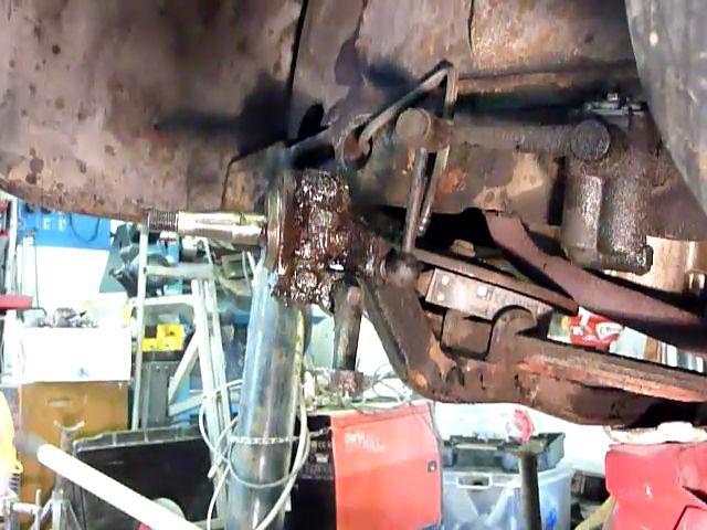

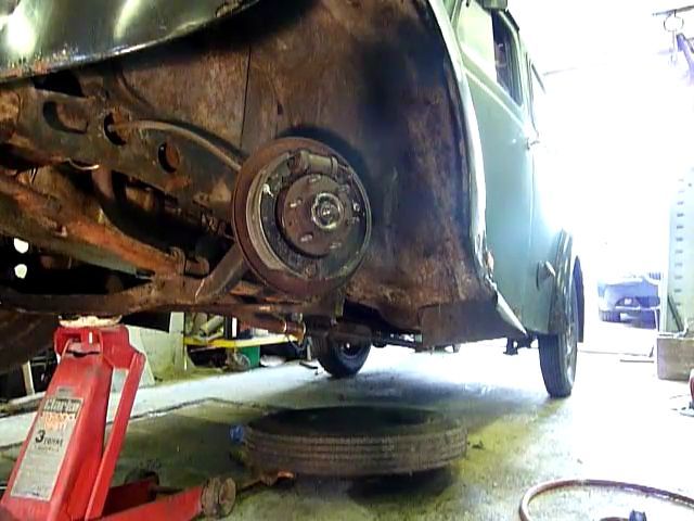

I'll set you a challenge a few months ago just prior to taking my Z Van for an MOT , I noticed a worn king pin, it was changed in just over an hour, which included fabricating the pin from a gearbox layshaft and properly reaming the bushes , my rule of thumb for reaming is that the pin should just be able to fitted in the knuckle by hand..it seems to be about right.

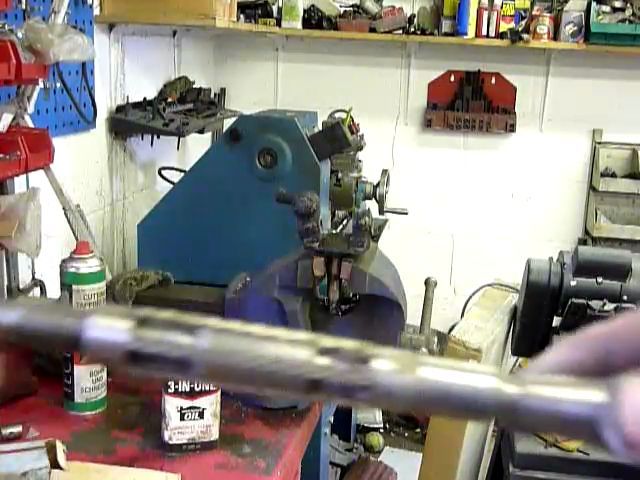

I use a slide hammer for the hubs, otherwise all you need are some punches, a hammer and spanners, unless the pins are seized; in which case the car won't steer, they should come out with a hammer and punch.
Cheers Dave
Postscript, I made a video of changing a Morris 8 kingpin, it will eventually find a home on the Morris Register website, here are some extracts, click on the picks to open the video
