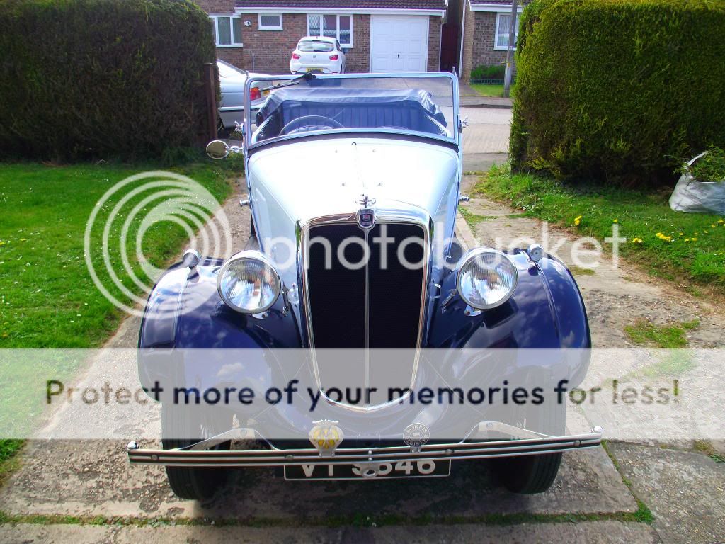

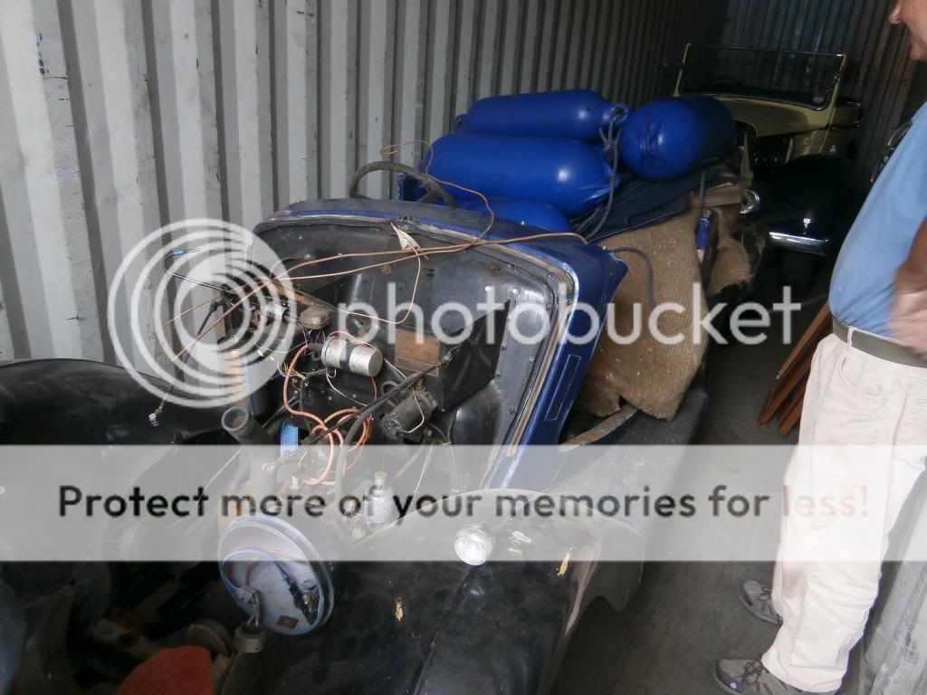

Pictures below start with car back in November when it was in a shipping container. I have been busy and it is now up and running (four speed conversion is great!) but requires some fettling - front drivers side spring needs retempering, unless anyone has a spare for sale?
Front sidelights are sidelights and indicators combined (led)

The sidelights were converted using a ba15d dual side/indicator bulb and socket from here.
http://www.dynamoregulatorconversions.com/combined-side-and-indicator-bulbs-shop.php
Very simple to do, I used a dremel to remove the old socket (single pin) and araldited (epoxy glue) the dual one on. Fit bulb, adjust white brightness by covering up front white led and job done. I did not need led flasher relays as the resistance from the rear conventional indicators is sufficient to operate the standard flasher.
