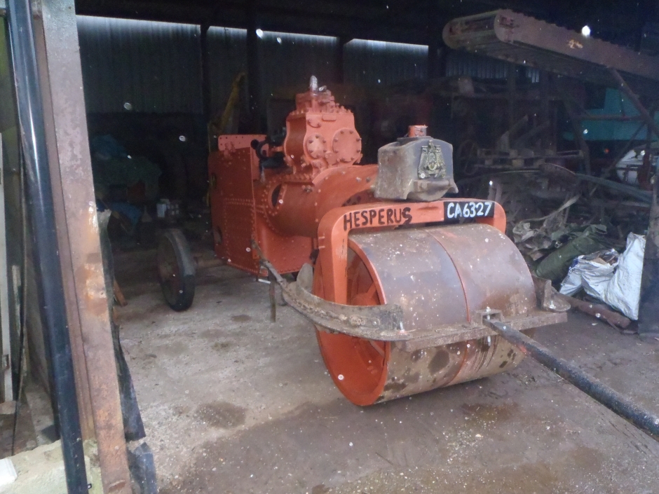

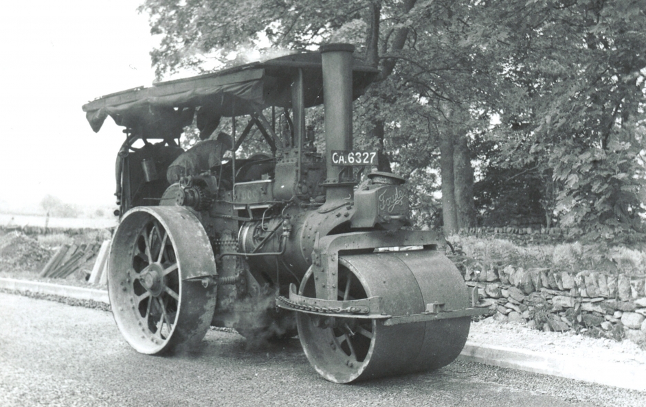

Secondly
Fowler 15489. CA6327
The engine is an example of a 8 ton steam roller built by John Fowler & Co in Leeds. Class T3.
The roller was supplied new to Wrexham Rural District Council in 1920, along with sister 15490.
I do not know a lot of its early history, save that it was finally registered on the general Denbighshire registration series in 1924 (It had been a requirement since 1921!) as CA 6327.
With the local Government act of 1929, responsibility for maintenance of rural highways was passed from the Rural District Councils to the County Council, and consequently the engine moved owners to Denbighshire County Council.
At some point prior to 1960 it had some sort of accident, resulting in a lot of damage. It gained a home made canopy.
I have photographs of it under repair at the Ruthin Depot in 1961, and I know it was based at Cerrig Y Drudion, usually parked on the strip of council land on the junction with the A5.
In 1962 or 3 the boiler was condemned and the roller sold by the council to the Lloyd Jones Brothers, who had intended further use.
Things didn't pan out, but some repairs were carried out and the machine was sold to George Bridson of Neston on the Wirral, effectively to be preserved.
George partially converted the engine into a steam tractor, and I saw it as such in the early 1990's. George passed (or sold) the engine to his son (also George!). 'Young' George returned it to a roller.
I bought it in 2003. So far I have overhauled the boiler. New boiler barrel, new tubeplate, new firebox. The restoration is getting there, but I've been at it 12 years allready!. Another 6 months may see it move under its own power. But it will be far from finished.
Here is a picture of it at work in July 1960 near Cerrig Y Drudion.
This is what it looks like, more or less now. Though a lot of work has taken place on parts not currently fitted.
