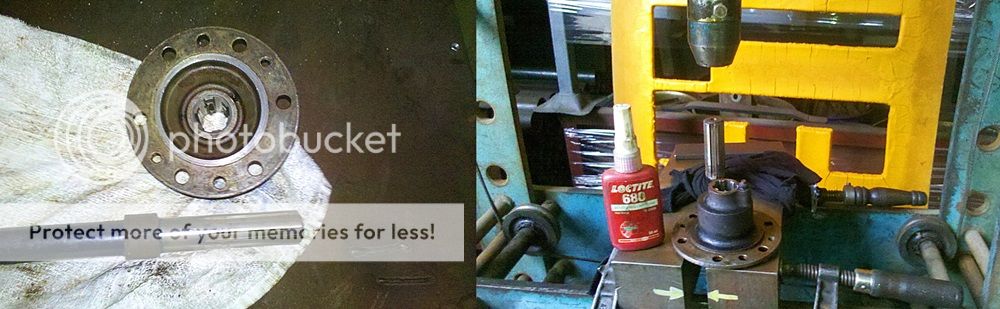

Well took said axle to work today. Pressed it out. Cleaned it up and had a look. Its not the first time this hub had been off this axle. It was a little chopped up, but the was very little play, although enough for it to be moving.
So I was recommend to Loctite 680, which has the same shear rating as 620. Applied said Loctite and press it back on.
Basicly Ill see how that copes and if it holds. If it fails, then Ill track down either a NOS hub or a good replacement set.
Thanks to Richard and Rosco for the advice.

Good job Craig Cool
In your photo would that happen to be a spiral wound cork oil retainer sitting on the half shaft? I recently trashed one of these and am waiting for replacements to arrive from the UK.
These seals should be glued into the axle housing before gently sliding the half shaft back through it - to help prevent oil leaks into the brake drum. Check out Bob Bryans website for details. M8 Rear Axle Oil Sealsand M8 Rear Axle Oil Leaks

Yes mate that is a cork seal. I accidently broke it and have to replace it.. It doesn't look wrapped though. Looks more like a cork collar. But either way needs replacing.
BTW mate where did you get yours from? Are they the same on an E series?

Cork axle shaft seals are the same for all Eights. If yours is the genuine article there'll be an internal spiral groove (scroll) which, theoretically, feeds oil back towards the diff with the rotation of the shaft, so obviously they're 'handed' and you need to be sure to place the correct one on each side. It goes without saying that when the car is reversed the scrolls feed oil through to the hubs, therefore it makes sense to avoid reversing as much as possible (the same applies to the scroll on the diff's pinion shaft).
