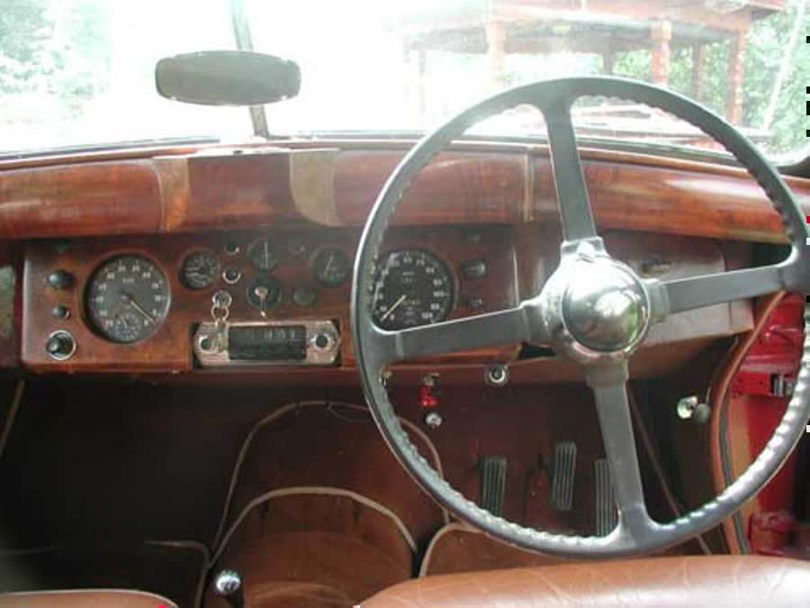

Rather doubtful, Ellis, IMHO.
Yacht varnish is much more viscous and yellows over time.
Since Alkyds had replaced most paint solids and by the early 1950s, acrylics were becoming common for oven baking etc, the lacquer used by Jag was probably what we used to call burnishing wood lacquer, a nitrocellulose product.
However, I personally would go for French Polish to bring up the superb grain and create a lustre without the dreadful synthetic uber-gloss of modern wood/plastic finishes.
This one is tired however about right (Apart from that bloody awful steering wheel!!):
http://www.victorycars.com/carimages/1952jaguar%20mark%207%20dash.jpg
However, this one is awful, with that synthetic lacquer which is totally non-original.
https://www.google.co.uk/search?q=Jaguar+MK+7+dashboard&biw=1150&bih=731&tbm=isch&imgil=7P8idP7eDYc80M%253A%253BewQ4M52gs4VsEM%253Bhttp%25253A%25252F%25252Fwww.classiccarsforsale.co.uk%25252Fcar-advert%25252Fjaguar%25252Fmark-vii%25252F1952%25252F195817%25252F&source=iu&pf=m&fir=7P8idP7eDYc80M%253A%252CewQ4M52gs4VsEM%252C_&usg=__IDS-QhqN3MUHsAj5IKGt8ScjnUw%3D&ved=0CDEQyjc&ei=dfCmVKmgG8jzUOe9grgL#facrc=_&imgdii=_&imgrc=7P8idP7eDYc80M%253A%3BewQ4M52gs4VsEM%3Bhttp%253A%252F%252Fmediastorage.classiccarsforsale.co.uk%252Fcf%252Fa3f19%252F31141%252Fe1c76%252F5f4d7%252F9b271%252F81120%252FJagMK7%252520011_880x660.jpg%253F1364353486%2526displayId%253D1002%3Bhttp%253A%252F%252Fwww.classiccarsforsale.co.uk%252Fcar-advert%252Fjaguar%252Fmark-vii%252F1952%252F195817%252F%3B880%3B660
