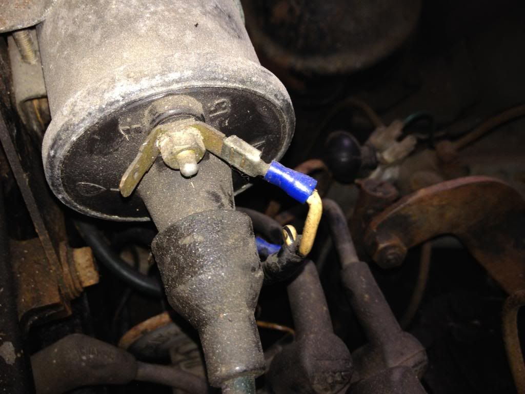

I had a quick look at the car yesterday. I drained the oil, which was as black as coal, and removed the oil filter. there's no number on it, so I'm sure my local factor won't be able to identify it. Speedy spares? Does anyone do a spin-on filter conversion fitting?
I'll need a new water pump.
The engine turns when I push the car in gear, and the brakes work, so I think I'll soon be ready to turn the engine over. However, I'm not sure how to tell if the car is positive or negative earth. I presume it started out as positive, but may have been changed.
Can anyone advise me how to tell? I'll post some photos of the electrics when I've downloaded them.

Your engine bay photos show two battery leads, one attached to a terminal, one not; where do the other ends of those leads go and which terminal is at which end of the battery?
Scamonomics
Joined: 28 Apr 2014
Posts: 24
PostPosted: Tue May 06, 2014 8:37 pm    Post subject: Reply with quote
Just to confuse matters, there are three leads...
the first is the uninsulated one under the battery tray. this one is connected to the car, so was obviously an earth but, since it has no battery connector on it, i doubt it still is.
The second lead is connected to an electrical component (see photo). This was connected to the positive terminal of the battery. However, the lead is long enough to reach the other end of the battery, and just because this is how it came doesn't mean that's how it's supposed to be. I know that the buys at the auctioneers played around with it. so I cannot rely on its current position being correct.
The third lead has a battery connector at one end and is loose at the other. It has a large ring on it for attaching to something.
so, my only thought is that the current set up is negative earth, but I would be grateful if someone could tell definitely from the photos. Or direct me to check for something specific.
Many thanks
Jab

Positive or negative earth? It probably comes down to preference. There's a control box, so presumably it still has a dynamo for charging, which can be polarised whichever way you like in about a minute, several threads on this forum covering that particular job if you search for them. I don't believe any of the other bits - which all look like standard Lucas stuff - are polarity sensitive. The only likely thing I can think of is if the car has a radio of some sort fitted, if so you need to have a look at that to see wether it's negative (most likely by now) or positive earth, and set the rest up to suit.
47Jag
Joined: 26 Jun 2008
Posts: 1480
Location: Bothwell, Scotland
PostPosted: Wed May 07, 2014 12:26 am    Post subject: Reply with quote
Jab,
Looking at the coil connections in picture 3 I would say that it is already wired Negative earth. To be sure compare the size of the hole on the battery cable in picture 6. If it's bigger than the other cable then that will be positive and the negative will be bolted to the body or the engine.
