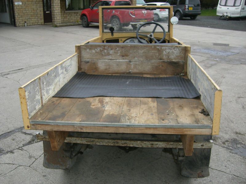

This is one of the pictures from the ebay listing. We had looked at a number of other old commercials before we got this one (I particularly regret missing out on a 1936 Morris L2 postal van at auction which was pretty much what I wanted). I went and picked it up with one of my (t)rusty transits and brought it back to shropshire from Bury.

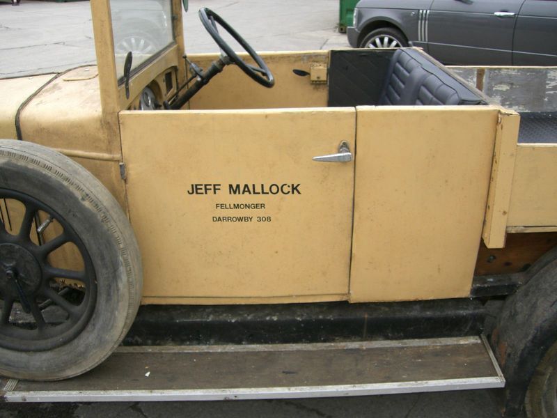

I will upload a few more pictures of the as arrived condition later/tomorrow. It has no history and no registration documents (now in process via the bullnose morris club) but we believe its a 1928/1929 changeover/hybrid model (should get more info from the BNMC when the dvla approve the registration). If anyone thinks they know anything about it please shout up (we have worked out the Darrowby connection and think it may be a film car - but no evidence of it being on camera to date). It was sold by Cheffins about 18 months ago from a deceased estate - but thats the limit of our knowledge.

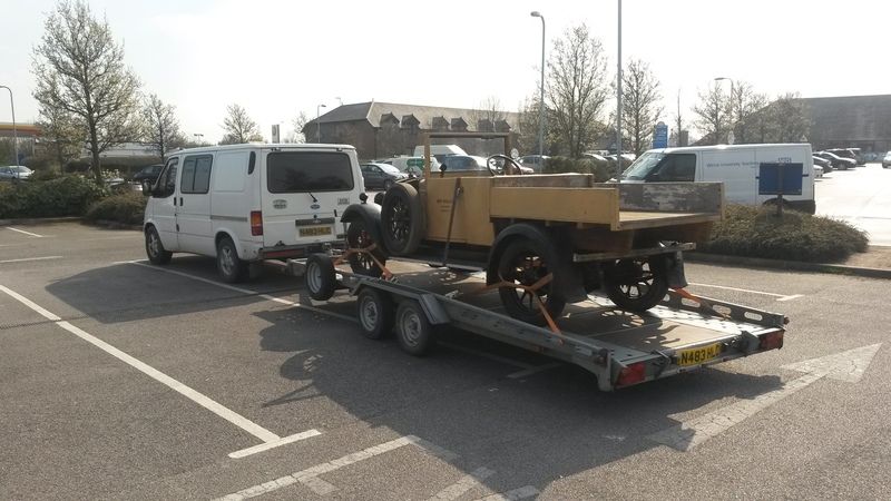

and here it is on the way home!

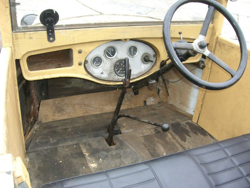

As you can see the dashboard is all wrong (60's smiths gauges) and as it transpires the speedo rotates the wrong way too! I have found the switches and dash panel for it, along with a working clock and oil pressure gauge (just need to find an ammeter and speedo with silver face now!)

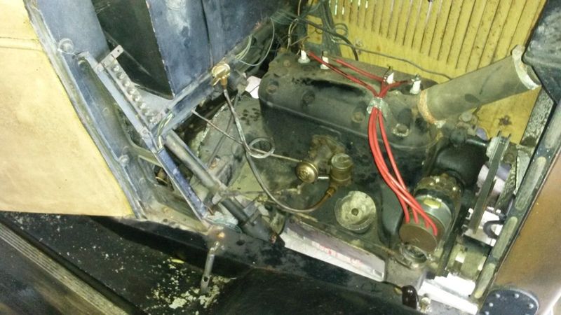

As it transpires it has a 1925 bullnose engine, sump and gearbox but with a flatnose head. We have tightened the dynastart chain (fiddly job) and a few other odds and sods... Its got the bullnose (smiths single jet) carb which is wrong for the car - so we have an SU for it Smile - needs the correct linkage though
Before we use it it needs a complete rewire, shock absorbers need new friction material and bushes and a few cosmetic tweaks. There have been a few small changes since the pics but nothing major.

It had a goods vehicle disk from the milk marketing board with a reg no of BAJ443 in the holder - but thats a much later reg! There are also a few other things suggesting it could have been a film vehicle (rudamentary dash, no rear lights, no weather proofing, no tailgate on the bed and only the sidelights wired) suggesting it was a quick sort out for filming... another give away is the applied dirt!
