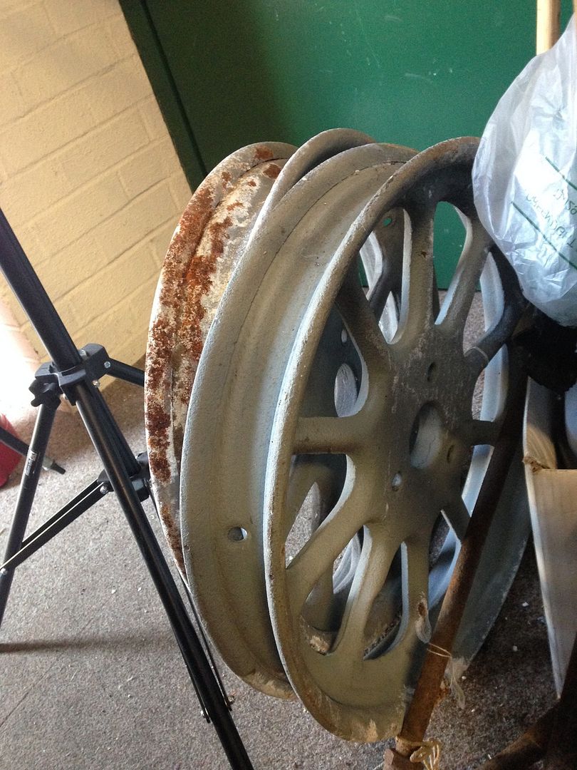

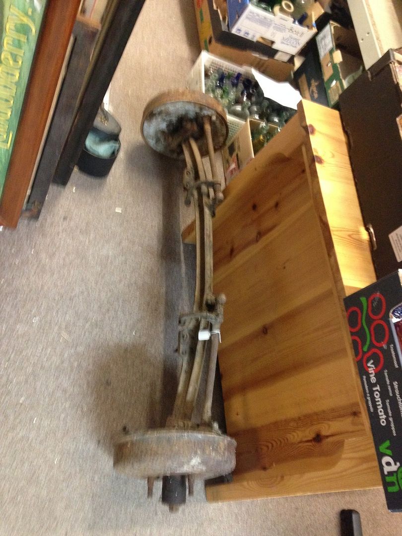

A friend of mine has a couple of random parts he believes are from a bullnose morris, he has a front axle and a pair of wheels, can anyone confirm if they are from a bullnose, and if they are of any value to anyone?
Sorry about the less than ideal photos!

I think the axle is Bullnose Cowley. The Flatnose is not as curved. The wheels are Cowley and would suit later Bullnose as well as Flatnose. Hope that helps
Andy |

The axle changed for the '29 model year and that appears to be an earlier one.
The later ones have much tighter bends and straight sections rather than a continuious curve.
I could do with another wheel for my cowley as its virtually ready to hit the road! |
