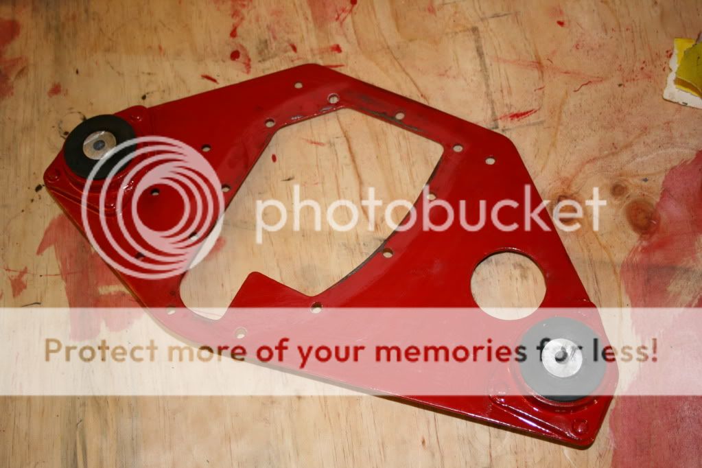

Here are some photos of 'the offending part' as Paul B called it Smile.
Quite a complex piece. External casting, a sleeve through the rubber, with top and bottom washers onto the rubber, and then a threaded ring tightened down onto the perimeter of the rubber. There are four mounts like this in total.
Hopefully that helps with ideas for refurbishment, or an alternate source.

Looks like a fairly standard Silentbloc type bush with a thick boss up the middle. I am guessing that the bush itself comes out of the casting - maybe with some brute force! Quite a few folks here make such bushes but as you are in Aus have you talked to Motherson Elastomer Pty Ltd 48-86, Powell Street Unit 4, 18-22, Bendigo, Victoria, 3550, Australia PH: +61 3 5440 2069
