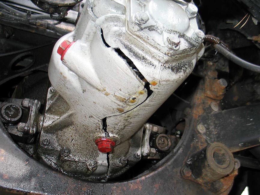

Our first was Célestine, a 1953 car discovered in a barn in the early noughties and restored by a garage owner. She is extremely well behaved, except for having an appetite for gearboxes. We did a couple in rapid sucession, both metal fatigue. One involved cracking the gearbox case from end to end, (http://1.bp.blogspot.com/-PLwI6oxCTyE/TtdXmnxJ4uI/AAAAAAAAI2I/LVlA4DBx4u8/s1600/celestine%2B3.jpg)the other was shearing a bearing mount where the axles exit.

That's certainly a spectacular gearbox failure!
What do you think caused it?

The gearbox case is an aluminium casing, and the design was very rushed. One of the things you shouldnt do with them is push start the car. I suspect that over 60 years she'd been push started a few times. The case cracked half way around a corner - hence the longitudinal split. To give her due, I was able to drive a couple of hundred metres with the case like that to get her off the road.

It was an expensive repair - had to source a casing in good condition, not easy with 60 y/o cars.
I didn't, however, let the side down: before starting work I did ask the mechanoc if it would buff out.
At the moment I am trying to source a casing in perfect condition, because I have a good CAD man on my side. If we can get the design right, with webbing and some 3D printing in titanium, I should never have an issue again.
