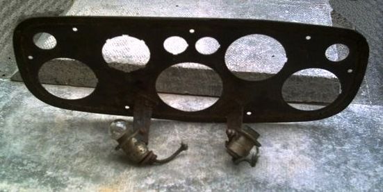

| Kleftiwallah wrote: | | ... I can see what you mean about the thinning of the dash but where does the illumination come from? ... |
Does this help?
This is the back of an Austin Ruby dash panel, but is fairly typical of the period. There are two bulb holders which is sufficient to illuminate 5 instruments (the sixth large hole is for the ignition switch); the holders are mounted (and pivot) on the pressed steel pillars, which are riveted to the panel. Oh,and the panel is upside-down in the pic! _________________ in the garage: a big empty space!
