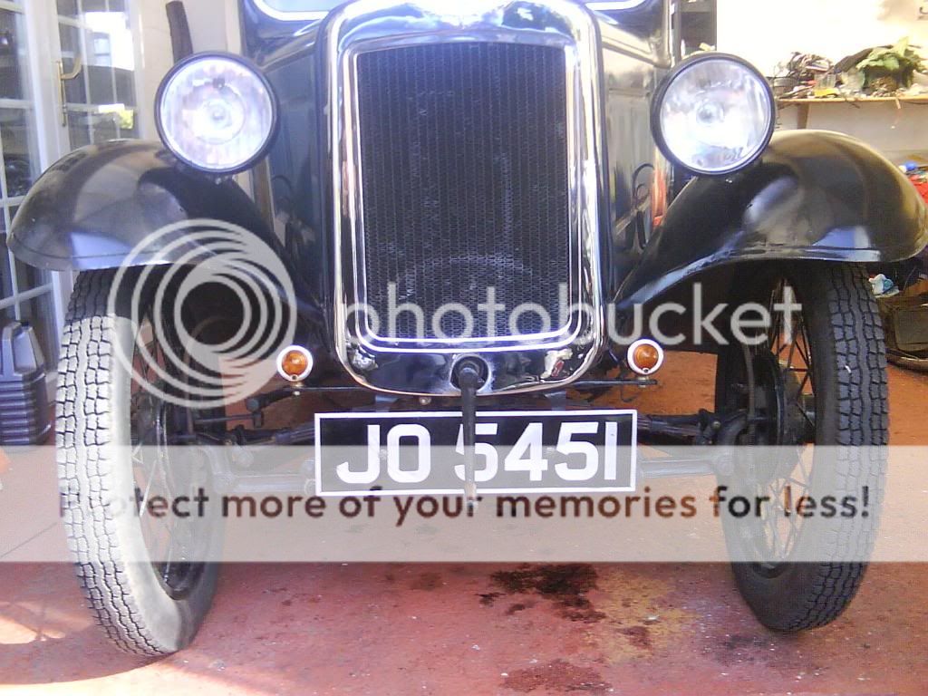

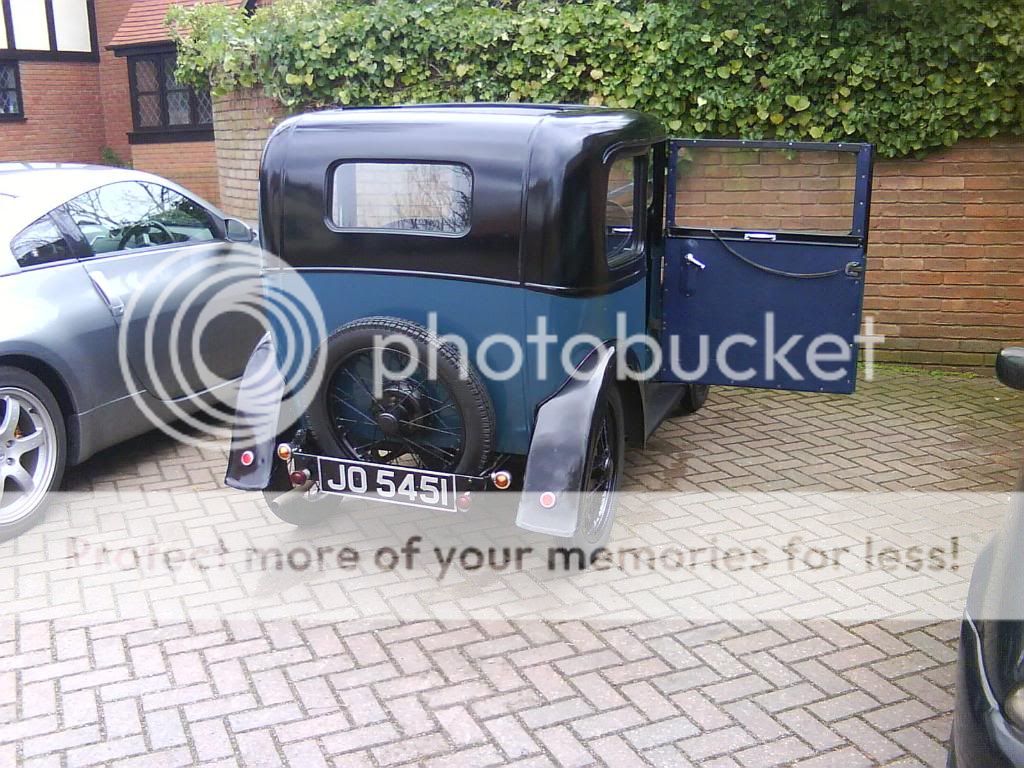

This is the first of a few small instalments about the other old crocks in residence at Hughes_Towers. Smile
Having sold his Ruby, my dad fancied an earlier A7. We found this one on Ebay, and ended up going to Colchester to collect in, about 50 miles away and driving it back. The car was running quite badly so most of the way back there were massive queues of traffic behind "Jo", with the speed dropping to 20mph on every incline.
However it's very sound, it was restored in 1998 and has been little used since. It is a very late RN saloon, registered one month before production changed to the RP saloon.

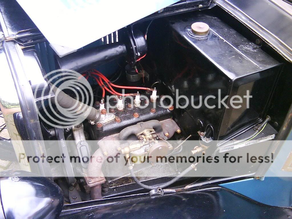

We adjusted the carb to get better running, although there is a problem with dirt in the (scuttle-mounted) tank, so an inline filter is called for.

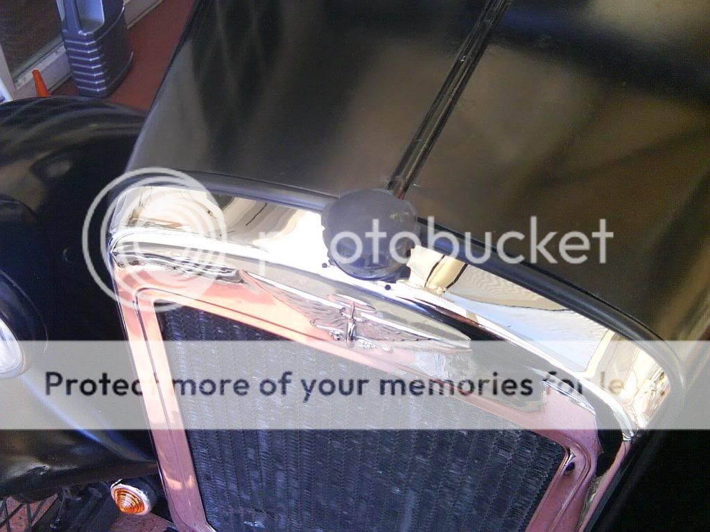

Plans for it are: Respray the bonnet as it has started to polish through to the undercoat, and recolour the front seat bases to match the original blue upolstery. Oh, and if anyone has a calormeter for sale that would fit the radiator, we would be interested Smile

Very nice Richard!
JO is obviously very closely related to my AMY!
What's been done to the front brakes? Those cables connecting from the top look very unusual.
It was built in August 1932 or earlier. The last month of the RN was September 1932 and that final RN had a 4 speed gearbox, a different dashboard and steering wheel centre, petrol pump on the side of the engine and the petrol tank at the back under the spare wheel. The swages along the rear of the roof were also absent. (Austin installed some presses that were big enough to press the roof out in one piece instead of three.) Not that I would touch it if the chrome is good, but the windscreen surround should be painted black on the RN, matching the headlamp rims.
The Calormeter that you require is a small square one. Unfortunately I do not have a spare, but I obtained mine at a British old car swap meet a few years ago fairly easily. It fits through a hole you will need to drill in the brass chromed radiator cap.

Hi Keith,
Thanks, I didn't realise there was anything wrong with the front brake cables. How should they be attached? The brakes work OK, just not quite as efficient as the Ruby was.
"Jo" was registered in August 1932. I have the buff and green log books showing the engine number which corrosponds with the engine fitted. However the bearings are getting a bit rumbly, so will need attention soon.
I didn't know about the windscreen surround, but the chrome is very good on it so I think we'll leave well alone!

Richard and Peter
The cross-shaft most certainly does twist under heavy braking, but this only affects the rear brakes.
The front brakes have a cable that forms a "vee", the ends of which are on the backing plates and the centre of the vee is mounted to a pulley arm on an equaliser that twists to automatically operate the front brakes with equal tension. (I hope this makes sense!) This vee cable runs under the axle and parallel to the ground. In theory this equaliser equalises the cable tension to both front brakes when the steering is turned.
The front brakes consisted of two leading and two trailing shoes in their original form, but I believe there is a modification that can be done to modify this to four leading shoes, which of course, will improve the braking considerably. This may have been done to your car.
The Ruby had the later Girling brakes with cast iron drums which were a lot better than the pressed steel drums on the RN. I know it is possible to fit the later brakes to the earlier cars, but I have never done this so I cannot advise.
