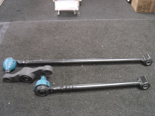

been reading up on rear suspension, and seen a WATT'S LINK, supposed to be better than a panhard rod setup, so i might go with the Watt's, found out a PT cruiser has one, they're about £60 on ebay, i'd be inverting it though, ie- the central piviot arm would be chassis mounted and the rod end's would be fastened to the axle, i'd have to fiddle about with the length of the arm's a bit to fit the pop though, we'll see,

PostPosted: Thu Nov 16, 2017 1:44 pm    Post subject: Reply with quote
How will that work then?
The yoke needs to be vertical and the bars horizontal and parallel when the axel is at mid travel.
Interesting to see how it's going to be fitted.

PostPosted: Thu Nov 16, 2017 2:37 pm    Post subject: Reply with quote
turn's out you can mount the Watt's above/below/in front and behind the diff,
but i'm thinking of mounting the piviot crank arm on a bracket off the central chassis leaf spring hanger/clamp, and the end's of tha arm's onto bracket's welded onto the axel, as in this pic, (but not as flash as this one) instead of welding the piviot point onto the diff housing,
i know you dont really need all this gear, i just like messing about with the pop, it's just my hobby,

PostPosted: Thu Nov 16, 2017 4:34 pm    Post subject: Reply with quote
I see now how it can be done, I can't envisage the pop ever cornering so fast that you'd really need it but I suppose the challenge is in the fitting.
