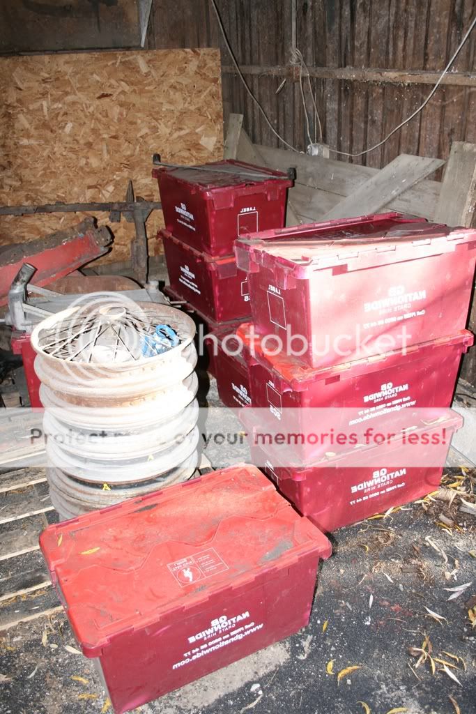

PostPosted: Wed Nov 10, 2010 12:33 pm    Post subject: Aero Minx bits Reply with quote
OK, thanks for the encouragement.
Here are a couple of shots of the boxes of bits. They do not show all of it as I have been moving some of it, particularly the very hard to find parts like the ally heads and original gear transfer etc. to better accomodation in the roof of my workshop. the wheels are very scarce as I found out when I had to get a set made for my other car. They share the large brake drum shrouding hub with Talbots of the same period. I have recently acquired a couple of the smaller-rimmed Talbot wheels just for the hubs in case I might need them for car number 3 (If I live that long)
Chassis now back and in paint, picture to follow. Also progress being made with making a new brass radiator shell, again pictures when I remember to take some.
[img][img]https://aero835.files.wordpress.com/2016/12/ash-frame-6.jpg?w=481&h=722[/img][/img]
Most of the bits are in quite good nick, you might even spot some new inner rear wheel arches that came with it all.
[img][/img]
The storage boxes are so very useful and came from a company called PLASTOR in Maidenhead
