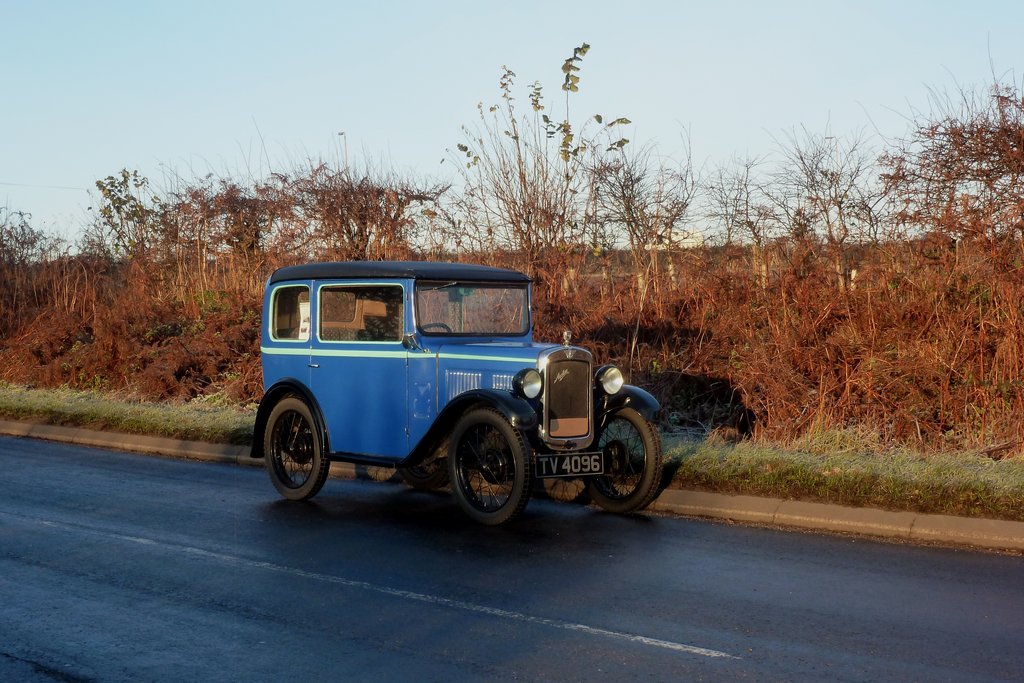

Try blanking off part of the radiator with a bit of cardboard; that's what I do every winter with my Austin Seven
