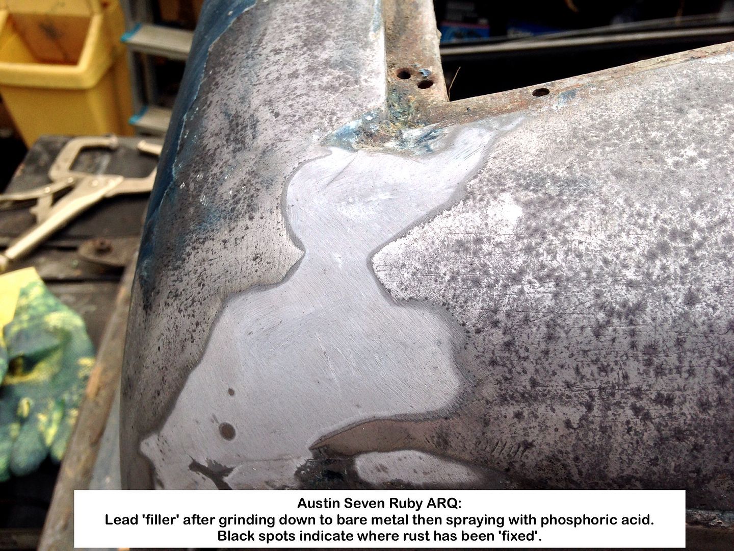

7 - Used a poly strip disc to get to bare metal, then sprayed with phosphoric acid.
The acid turns white on contact with rust, then black once the rust is 'fixed'.
What I didn't do was use either a microfibre or tak cloth to remove the rust dust left on the surface.
Now it's either the rust dust turning black or it's actual rust still in the pores of the metal.
Next time, out of curiosity, I will do as Dan Gelbart suggests and scrub the metal with Vim in order to get into the pores, then spray with acid and see what happens.
Yes I know, overboard, but that's me

I used an abrasive disc under the wings same as everywhere else. The paint seemed tougher and harder to get off though.
I used this http://www.rust.co.uk/000-custom-epoxy-421-rust-proofing-body-primer/p501025 which I sprayed. I shall get some epoxy mastic to do all the bits and bobs I think or I shall spend half my life cleaning the spraygun out. I am short of space for hanging parts up to paint.

The measles are almost certainly due to the undercoat being left too long before the top coat went on; by too much time a day can be too long.
If you are going to leave undercoat any lenth time before the top coat an epoxy primer is the thing too use. many a fine looking respray has been ruined months later as micro blisters appear in the top coat, due to trapped moisture absorbed by primer or filler.

Except Dave mine was exactly the same and I can't imagine anyone has stripped the paint off before.

Shocked
I thought mine was bad, but BH your's takes 1st Prize without doubt.
It must be pretty well 100% humid in Brum for that level of rust.
Your car must have been left outside in underwear for a while.
Surely a company like Austin would have done their best to prevent this happening, even for the Seven.
