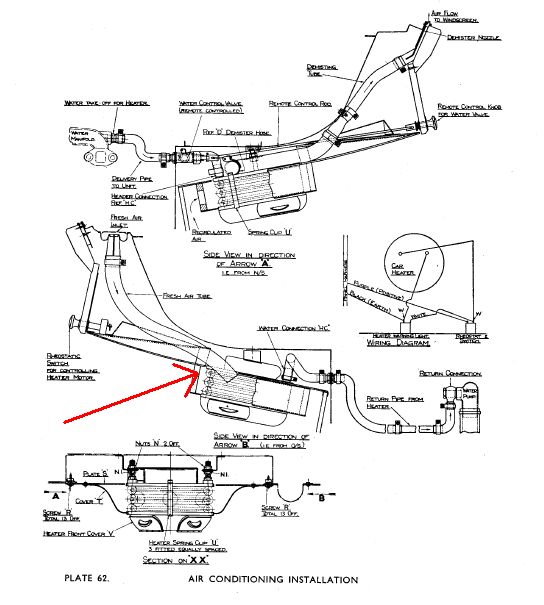

Yes, my SS was never fitted with a heater when new. Fortunately it has an alloy water manifold with relatively flat sides so it wasn't too difficult to drill it and fit a hose connector. For the other connection I found a convenient bottom hose from a Vauxhall Firenza that had a 1/2" T connection on it.
With your TC you might need to solder a couple of pipes into the header and footer tanks of the radiator although a closer location to the water pump might be an advantage so the T off the bottom hose might be more efficient.
After the war the rather similar MkIV Jaguar came fitted with a heater (or air conditioning as they called it) so I used the same type of Clayton heater and also the fittings for passing the hoses through the bulkhead, one of which includes a tap.

Thanks for the diagram Peter. I like the Clayton heater but I don't think it will fit in the MG. I need to find a very compact unit. I would have thought the problem with plumbing into the radiator is that the heater wouldn't start working until the engine is up to temperature. Then again the bypass loop (which was my first thought) is apparently closed off when the thermostat opens. That kind of leaves the hoses - or as I have seen in photos - direct connection to the head.
Plumbing aside, I recently took a look at electric heaters. What amazed me was the amount of power they need. One I looked at which seemed to meet my requirements was rated at 500 Watts ! With a 45 amp alternator at 12 volts, there would be a rapid discharge - or at least that is how I calculated it.
