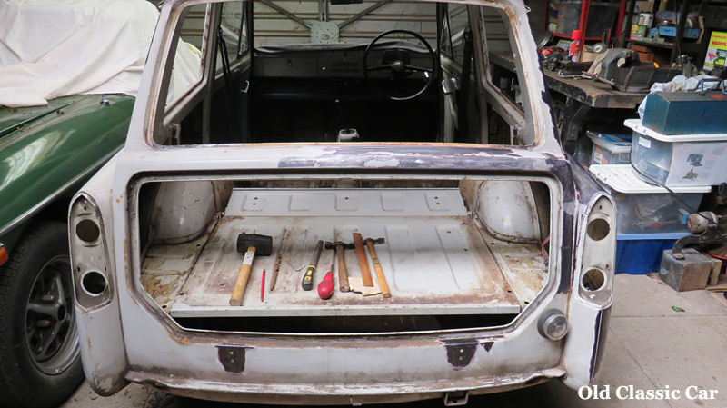

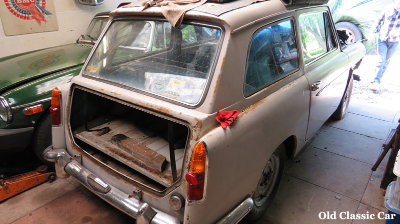

Firstly, boot off. It's gone in the lower LH corner and might be a fiddle to repair.

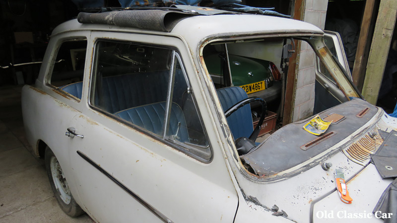

Glass front, rear, and rear side now removed, to save them from flying sparks and also to reveal any tinworm behind the rubber seals.

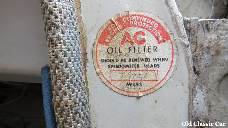

Care needed to preserve this early 1960s oil change sticker

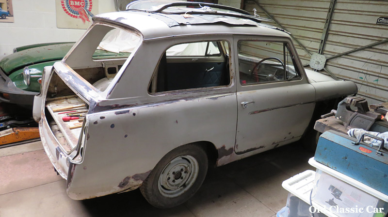

Rear lights and bumper also off by this point. Fortunately the copious amounts of Waxoyl that I used to spread around underneath, and almost pour down inside the rear wings, has helped. The only rot is in areas that were already exhibiting signs of corrosion when we received the car in the 1980s - ie fore and aft of the rear wheels, where A40s tend to go anyway. The bootfloor and the rear valance, seams etc, are good overall.
Any areas of surface rust were rubbed down and given a quick treatment just to slow down any corrosion.
While sat having a brew, I noticed that both rear wings had a slight ding in them, from the inside, so I dug out a few hammers and gently tapped them back to shape.

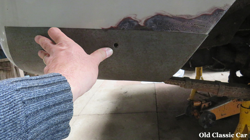

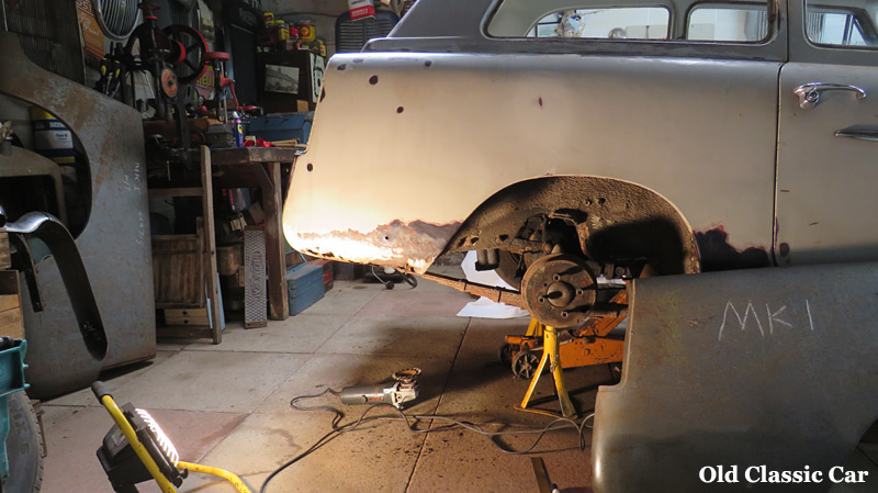

Time to have a proper dig at the crusty lower corners of the o/s/r wing. Note the two NOS wings. The o/s one I've had "in stock" for a few years, the n/s wing is a more recent find. Together they'll offer up all the repair panels I'll need for the outer rear wings, and the remaining steel will suffice for any other repairs that are needed (so using BMC-sourced steel throughout).
Lower rear wing section sliced from the NOS wing, and offered up in place before final trimming. Handily, the quarter bumper mounting hole helps with alignment. There are repairs to do behind this section before it can go on - I also need to practice my welding as I've done none in recent years - the offcuts from the surplus areas of the new rear wings will come in handy for practice.

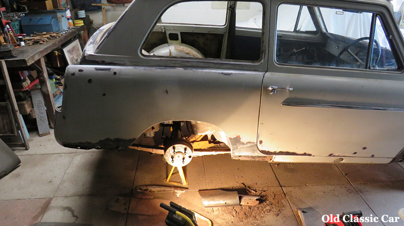

Both front and rear of the o/s back wheel now cut away to reveal a few minor repairs that are needed. Both repair sections have been cut from the new wing by this point.
I also removed the tank, with it out of the way I was able to confirm that the boot floor and spring hangers at both ends are rock solid, not something that can often be said with project A40s/A30s/A35s/Minors etc.
