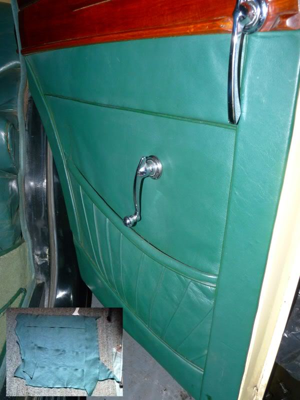

PostPosted: Wed Dec 02, 2020 10:17 am    Post subject: Reply with quote
Mine were all in bits when I got the car so I had to do a bit of stitching before attaching to new plywood and one rear one was missing so I needed to make it from scratch copying in mirror the one on the other side. I went through quite a lot of sewing machine needles. The little inset shows me piecing together the various parts before sewing.
