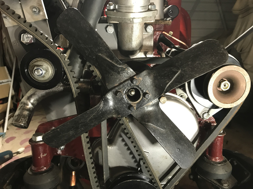

The first two photos shows the original fan blades as fitted to my XPAG engine. They are attached to the water pump by four 1/4 BSF set screws.
As can be seen there are one or two issues.
Firstly, the blades are virtually touching the supercharger drive belt. A spacer would easily fix that problem and also take the blades closer to the radiator which would be no bad thing as they are too far away at present.

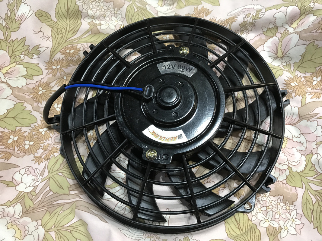

My biggest fear is that these blades have been known to fail with disastrous results. This has prompted me to buy an electric fan. Not only is there no danger of fan blades breaking loose but modern fans are much more efficient and those with curved blades can also be quieter.
This 12 v. 80w multi blade fan is thermostatically controlled and has an over ride switch and light. (Turn it on or of at will)

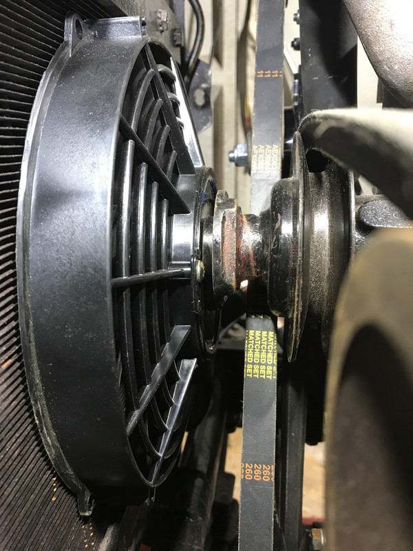

When offered up it becomes clear that the fan housing fouls the water pump boss.
I don't know whether to cut off the boss or to buy and fit a belt driven MGB 7 blade fan.?

Can you offset the fan so that the centre isn't lined up with the water pump? That might give you enough room.

I have tried moving it to one side or the other but it is not possible without considerable design changes.
As you say it needs to be a "puller" and that was a major consideration when choosing which fan to buy.
I am inclined to cut off the redundant water pump boss - but if I do that I would be making it impossible to use the MGB (yellow) fan; or for that matter, the original blades.

Ray, when you say that the original fans are known to fail im guessing you mean the spot welds can let go? I can't think what else would break .
Could you just get some extra spot welds added?
Or drill some holes through the blade and central part and get them plug welded.
Or drill and add some steel snap head rivets.
Or small high tensile nuts and bolts with the ends peened over so the nuts can't come undone.
Or fit an early B-Series metal fan if your not keen on the plastic one. MGA, Wolseley 1500 etc.

I am assuming metal fatigue is the cause but I will need to investigate further.
Rick had a blade break off his Dodge and I have had one go on my Austin Seven but they are relatively slow revving engines and two completely different fans!
The XPAG is a different animal altogether with a reputation for wearing itself out prematurely such is the RPM for any given ratio. I don't suppose fan blades have broken as frequently as some people would have you believe but such is the reputation that many cars now use the plastic MGB (yellow) fan. I fitted one to my Triumph GT6 I seem to remember but I eventually replaced it with a Kenlowe which was much better suited to that 6 cylinder engine. It is that experience - and a fear of what a fly away metal blade might do - which led me to buy an electric fan.
