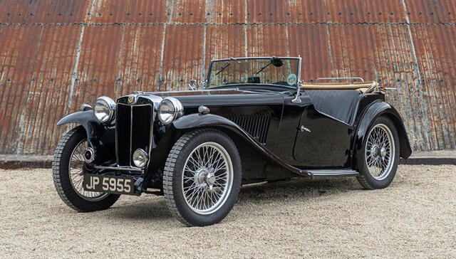

PostPosted: Mon Dec 14, 2020 1:01 am    Post subject: Chrome or painted wire wheels ? Reply with quote
I thought I should get the opinion of contributors as to which they think are better.
I wouldn't normally have given the matter a moment's thought. Painted wire wheels have always been a better choice because they can be easily repainted, whereas chrome tends to go rusty; and no one wants to re chrome them if they do.
That was until I discovered that the spokes on today's chrome wire wheels are in fact stainless steel!
Let us assume maintenance is not an issue.
Which wheels LOOK better on an MG TC ? traditional silver painted/ powder coated .... or chrome?

Ray, I like the traditional painted wheels.

In my yoof I put chrome wires on my car. Then I grew older and wiser and realised that in the day they were an option and that most cars had painted
wires, which turned out to be stronger than the chrome ones too. Taking it one step further, many pre-1960 cars had the wheels painted body colour too, a style I find pleasing. Also, painted wires are so much easier to keep clean! No, for a TC, painted are the way to go. Chrome would look out of place.

Painted definitely, IMHO Smile

I agree, painted every time. I particularly like wires painted in a contrasting colour, although I think for the MG silver may look best.
