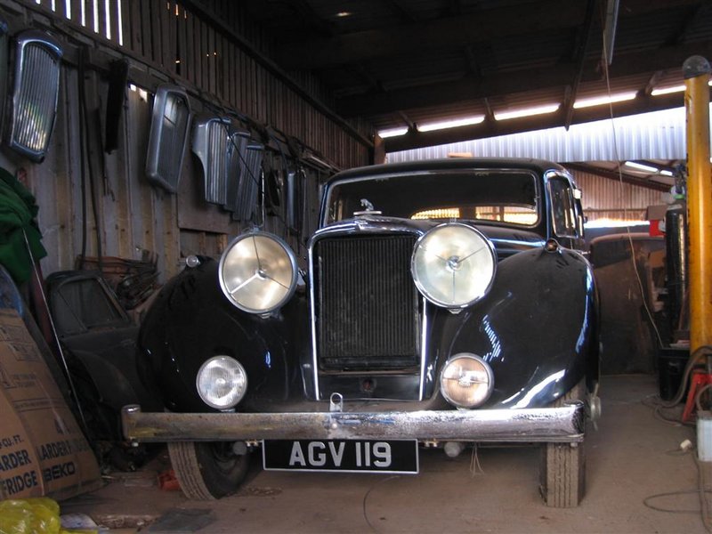

My garage at the house is quite small. I just have a working area about 10' x 10' in front on the space for the SS so a fan heater works fine. For many years previously when I was helping my friend with his extensive car collection in a cow barn with open slatted walls all round we used to use one of those very noisy "rocket motor" type things that burn diesel oil but it was a rather temperamental thing to get going at times.

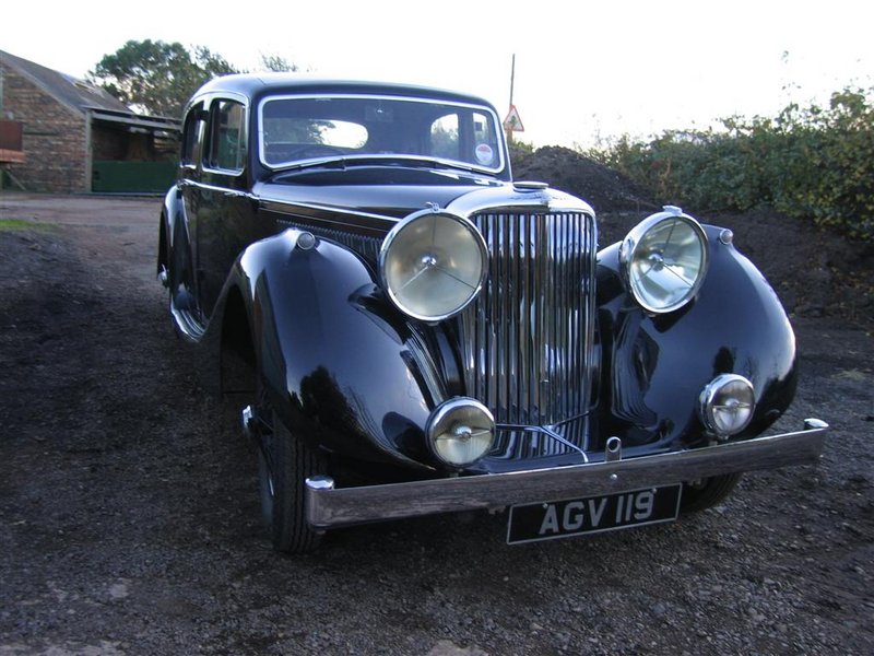

That car looked a bit more respectable after we'd done some work on it.
