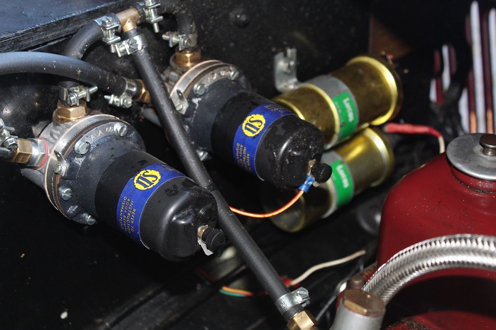

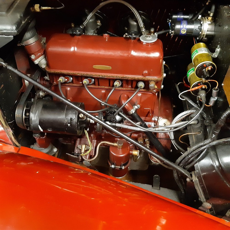

Perhaps someone could explain what is going on here and how it is wired?
This XPAG engine is being supplied with two petrol pumps and two coils. Seemingly two condensers are needed as well?
DM

PostPosted: Sat Feb 13, 2021 8:59 pm    Post subject: Reply with quote
The second coil is not wired, it is in place as a spare allowing the wires to be quickly swapped over.
Can’t see the wires and pipes on the second pump but expect it is a spare as well.

PostPosted: Sat Feb 13, 2021 9:14 pm    Post subject: Reply with quote
It looks like the low tension of the two coils are connected (via two condensers) somehow.
The two pumps are also in tandem.
Worth doing? or overkill?

The car is a TA and has (wiseley, in my opinion) been fitted with an XPAG engine. It has definitely been used for some long distance runs. Hence the velcro!
Here it is. Nice one I think.

PostPosted: Sat Feb 13, 2021 11:31 pm    Post subject: Reply with quote
Personally, I don't see anything more than installed redundancy with a very simple changeover system. The unused coil has no electrical connection.

PostPosted: Sun Feb 14, 2021 12:21 am    Post subject: Reply with quote
What I see is a wire connected to the lower post of the top coil that joins the lower post of the bottom coil. It seems to be connected to two condensers.
The petrol pumps are plumbed together but I can't confirm their electrical connection.

PostPosted: Sun Feb 14, 2021 1:19 am    Post subject: Reply with quote
To utilise Coil 2, move the LT cable and HT Cable. Ignore the capacitor, only one is in circuit.
SU Pumps. The male spade connector on the one nearest the camera has no cable, part of the spade is visible.
It is all what it is, there is nothing other than redundancy and easy change over.
I had a Mini with which we did considerable long distance trips across West and East Europe then a much modified Cortina Estate that did similar and North Africa. Multiple redundancy and spares were order of the day. Example: The Mini also had three petrol pumps. Two connected to the two isolated fuel tanks, installed as per the Mini Cooper and a none connected spare.

PostPosted: Sun Feb 14, 2021 1:13 pm    Post subject: Reply with quote
In this set up there won't be a reliability improvement ; if either the coil or pump fail, it still involves stopping, opening the bonnet and swapping a wire.
To change a coil or fuel pump (with the spare unit in the boot) is a 5-10 min job, so the only benefit in having them fitted this way is where speed is important, as Alastair comments its probably originally from a competitive set up where 5 mins time saved could be critical.

PostPosted: Sun Feb 14, 2021 6:50 pm    Post subject: Reply with quote
Paralleling the pumps will permit greater flow rate but I doubt that tht would be required with the XPAG. The 3½ litre SS Jaguar used this arrangement but I don't think it was even necessary there. Fitting the double contacts is well worthwhile though for reliability.
I have seen two pumps fitted to other cars where a supercharger is used but I don't know if this was done from experience or as a precaution. Mine has the larger 1 3/4" SU (as opposed to the 1 1/2") and having been advised that the engine runs better with being a bit richer I wonder if I will need two pumps?
I suppose the proof of the pudding is in the eating.
