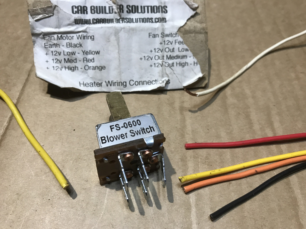

The four wires red, black, orange and yellow are attached at the blower end by a multi connector. The other ends are to be connected to the blower switch.
The switch has five terminals:yellow (low), red(medium) and orange (high).
The 5th terminal is for a 12v feed. Is it B or C ? and does it depend on positive or negative earth?
The relay has a white wire from 85 to (presumably?)a wire from the switch... if so which one?
The next question concerns the yellow wire from 87 on the relay. It presumably joins to the other end of the same wire that goes to the blower. If so, which one?
In other words I wish to put a relay in between the switch and the heater but I don't know which wire to cut.
I would appreciate any help.
As I see it, you'd need to have three relays, one for each speed, and wire them individually to control the L, M and H wires from the switch to the fan motor. It'll be interesting to see whether anyone more knowledgeable has a better solution, but I can't see how you could keep the speeds separate using a single relay.

You would only require a single relay for the 12v feed.

Forgive me but I thought the wire from the relay needed to be connected to a wire that took current from the switch rather than supplied current to it. ?
If that is right then perhaps the "B" outlet should go to the relay?

I am adding relays but you are right. I am thinking it is
not required and it's too much faffing about. I need to think what I am trying to protect. The switch. It is only worth a few pounds so not worth the time and trouble.

One thing which I am not sure about is what I need to do to about fitting the heater with my car being positive earth.
Because I don't really understand electrics I need to take advice to prevent me from making an expensive mistake. Will I need to swap over some wires or will the motor burn out run backwards?

I have spoken to Car Builder Solutions about the heater and the guy said just reverse the wires for positive earth. Sounds simple enough! Very Happy
