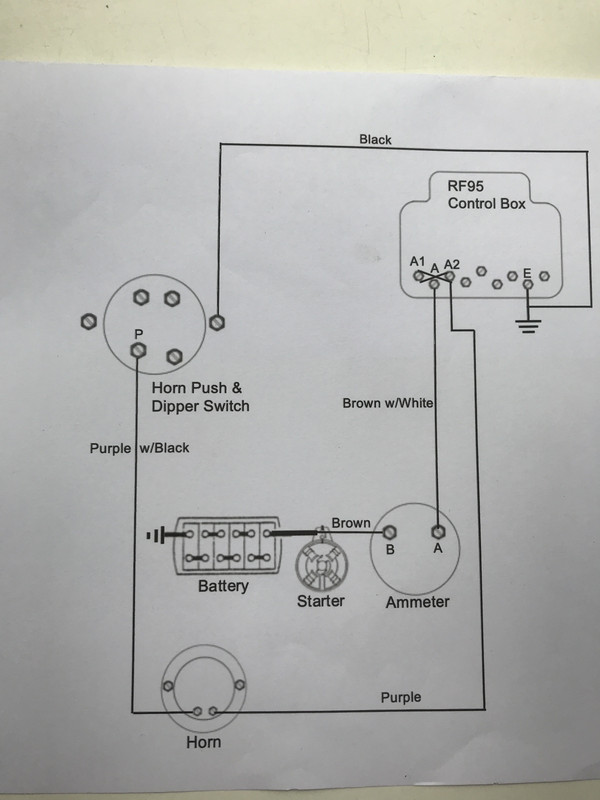

This diagram is for the TC horn as standard fit. In an attempt to preserve the ancient (and expensive to replace) push button I would like to add a relay. The horn button completes the circuit by grounding when pressed which is different from other circuits I have seen.
I would be grateful if someone could show me how a relay would work with this diagram.
(for example should I cut the purple/black wire and join the wire from 85 to the switch side and the wire from 87 to the other end to the horn.?)
I have positive earth and my relay has a diode so 86 is ground.
Thank you in advance.

Ray I'd have thought you should be the site relay guru by now! Wink
If you want to fit one to the horn circuit, its a cut and paste of the other circuits where you have fitted relays; the original switch now switches the relay coil, making sure you have the polarity correct if a diode is fitted, the relay contacts now complete the horn circuit.

I may or may not bother with a horn relay. It is more about trying to understand how to do something rather than staying ignorant and never know.
It looks to me like there is something different if pressing the horn button grounds to complete the circuit instead of allowing current through to the relay?

Dave. If I were to divide the purple and black wire and insert a relay with T85 going to the push button and T 87 connected to the other end of the same wire going to the horn ...it wouldn't work would it? It would be applying 12 v to BOTH sides of the horn, surely.?

It wouldn't work at all as you would have the relay coil an horn wired in series.
All you need to do (and this applies to an addition of any relay) is replace the load with the relay coil (polarity sensitive if the coil has a diode across it), now you'll have a pair of contacts within the relay that will make when the horn button is pressed (30 & 87) . The horn can have a permanent earth or permanent live on one connection, the other horn connection should be attached to 87with 30 connected to earth or live; the opposite of what the permanent connection to the horn is .

Really all I want is to be told what colour wire goes to what number on the relay given that 86 is + ground.
My previous post was attempting to teach you to fish Wink
Here is the meal Very Happy when a relay has a diode the cathode it is connected to 86 of the coil, 86 should be on the +ve side of the circuit , in this scenario for a negative earth car 85 & 86 would be reversed.

Thank you so much, Dave. The theory is no doubt interesting but not what I need right now.
I have been told by someone I know that the horn would need to be earthed. Originally, the horn is insulated and grounded from a wire from the control box as shown in my original post.
I have since learned that it depends on the type of horn. It's always the same but never quite the same if you know what I mean.
This has left me confused and frustrated and doubting myself to the point of throwing in the towel with this car altogether.
What you have posted has explained nice and clear what I need to do.
